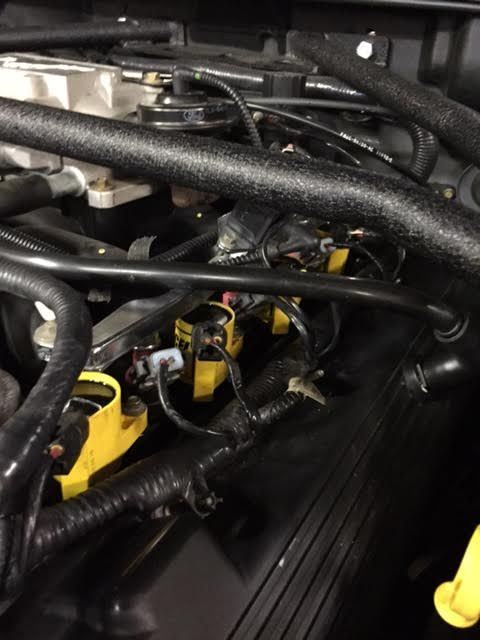

Well, I went ahead and installed new Accel plugs and the Accel Super coils this morning, took it out for a test ride after, all I can say is WOW! Definitively noticed the difference.
The spark plugs I took out where original, about 93,000 miles. I will let you know how they hold up

I have a feeling the positive difference you noticed has more to do with replacing the plugs (93K is a solid 43K longer than they should have been in there) but if you're happy then I'm stoked for you as well.
