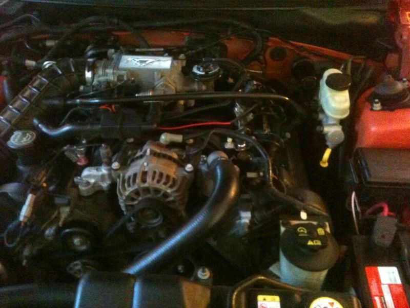

Engine bay before:

Engine bay after
Had the biggest headache in the world after the header install. Engine light was on showing 9 various codes and the car wouldn't idle anymore! Cliffyk came through as a life saver on the forum. Turns out one of the 02 and header circuits had the grounds switched.

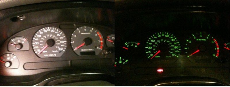

Finally, decided to start working on a blue LED interior swap. Got some white reverse glow gauge faces installed.
Before:
After:

I got the same instrument brezel as you but when I put my parking lights on it lights up blue, and when I click the lights on, they switch off to wer it's just the orange pegs illuminated. Did you have the same problem?

Shae04GT, my dash lights stay lit up on both the park light and head light setting. I would check your wiring. I used the frame rail at the back of the little opening in the dash behind the cluster as a ground. Took some sand paper and cleaned up the area, then crimped a small loop end onto it so I could use a sheet metal screw to secure it. I also cut off the dimmer that the aftermarket dash insert came with and wired the positive and negative together, then cut the blue and white wire from my headlight switch and tapped into that. That way I can control the dash lights with the same **** as the other lights. I hope that helps, if needed I can elaborate more and maybe get some pictures.
