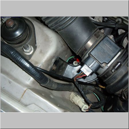

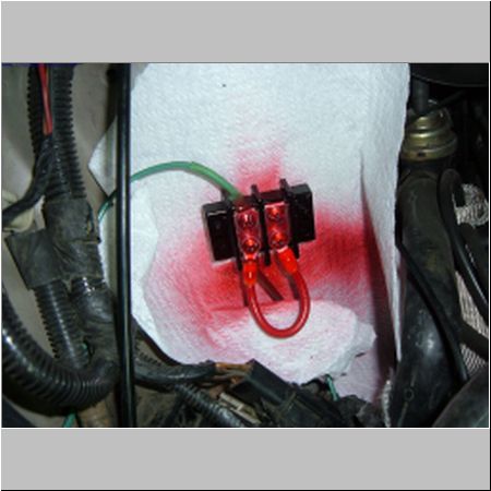

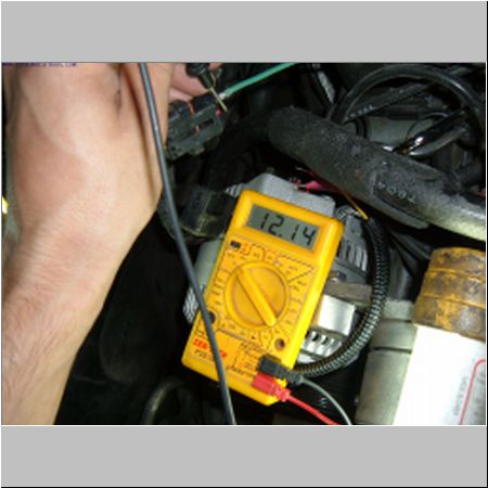

<u>Alternator upgrade</u>
<u>DIY 12V key on source</u>
I dont see a reason to cut wire terminals or plugs off if you dont have to or dont benefit from it.
I performed the alt upgrade on my 1991 it was the last thing I did before taking it out and it was totaled from behind. Well. I did it because I like to keep it clean, but now Im taking off my g*damn alt and wiring so the d*mn leaches at the insurance company dont get it... and can simply plug my stock unit back in because I did not destroy any wiring. Also I had wired up a +12v switched dist. block during the alt upgrade.
http://www.thatmetalbox.com/automotive/3g_alternator/
See pics, sorry they are not in order...
Here is my passenger side distribution block, sprayed with battery terminal protector (I did a drivers side one too)
Here is how I mounted it: no drill holes, the fox engine compartment allows you to mount so many items in the myraid of factory holes
Here with the intake back on its hard to see
as the items I used take very very little current, I was not too worried on some items - but on the pass side I had one of these switched 12v going to a relay utilizing 12v direct from battery so I could pull some amps, anyway I used a spade to pull power out of the old harness from the plug I did NOT cut off the loom, here:
