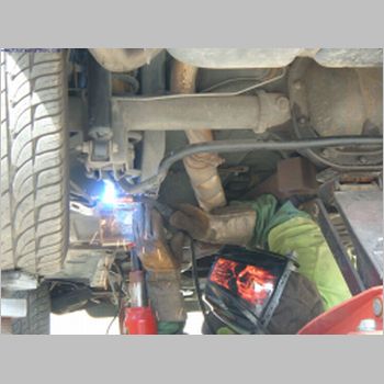

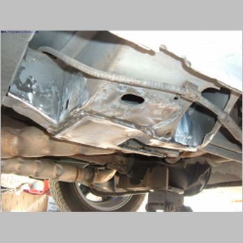

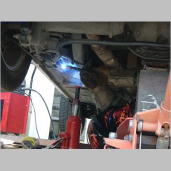

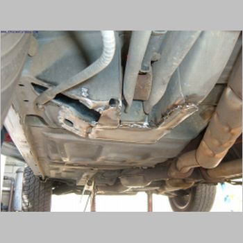

you dont have to remove anything - well I did not and I just welded the type you are talking about along with the thpe PRO50SC is talking about along with massive subframe connectors and I had the full suspension bolted in and torqued to spec while all welding occured
http://www.thatmetalbox.com/automoti...angBlanchWeld/

Default RE: torque box reinforcement
newest pic done 5-18-08
Battle boxes and torque box plates and full length subframe connectors with welded seat plates, none needed suspension removal, the battle boxes simply needed a bolt taken out and immediately placed back in. The way I have done it you would install the subframe connectors last, I wanted to see how it would work to install them on top (or underneath as it were) the torque box plates... since the sub frame connectors themselves had a built-in half plate... worked out beautifully I must say. Best of all
