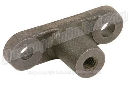

You can drive yourself nuts trying to figure out SBF brackets & pulleys if you have a mismatched setup so you need to decide which you want to use and get a complete setup. What bracket setup are you using? 69 or 70 and later? They are different.
There is a particular bracket that is needed for the 351W alternator in both cases vs the 289/302. It mounts on the head passenger side head.
Here is the bracket needed for the 1969 alternator setup:
And this is the one used for post 69:
