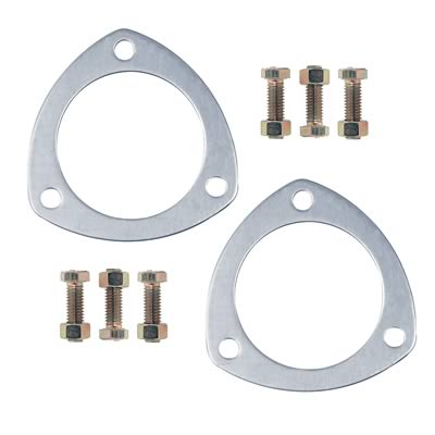

always had go0d luck with the aluminum gaskets pictured above, and my flanges sit LOW
