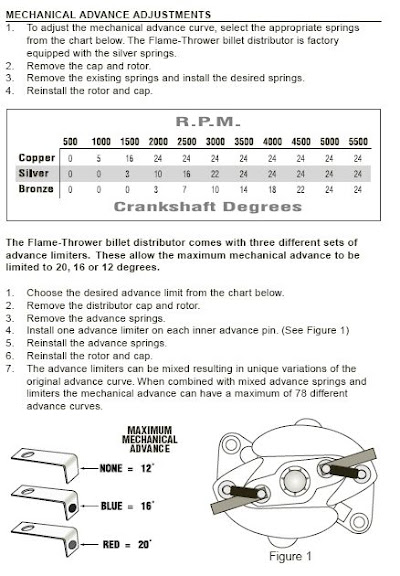

ok kalli, heres what i would do at this point, set your initial where the engine likes it, advance it till you get max vacumn or rpm reading and tighten it down, let it sit for 2 or 3 min then try to restart it, if it starts hard retard it till it starts normal and check your timing and note what degrees you have, now you have your initial, now you want your max timing to be all in by 2500-3000 rpm, no later. try a lighter set of springs to get it to come in sooner. ive gotten lucky already by glueing small pieces of vacumn tubing over the advance pins to limit total advance, some guys as mentioned above actually weld the slots, a lot of work but its guranteed to work! try to limit the total timing to 36-38 degrees no more or you will have a ping, this should work well enough that you may not even need the vacumn advance. and im sure you already know to have the vacum hose off the vacumn advance and plugged while doing all of this. good luck it takes patience but the results are well worth it, by the way i feel your carb is too small for your app, if you can try a 750 i think itll put a **** eatin grin on your face!

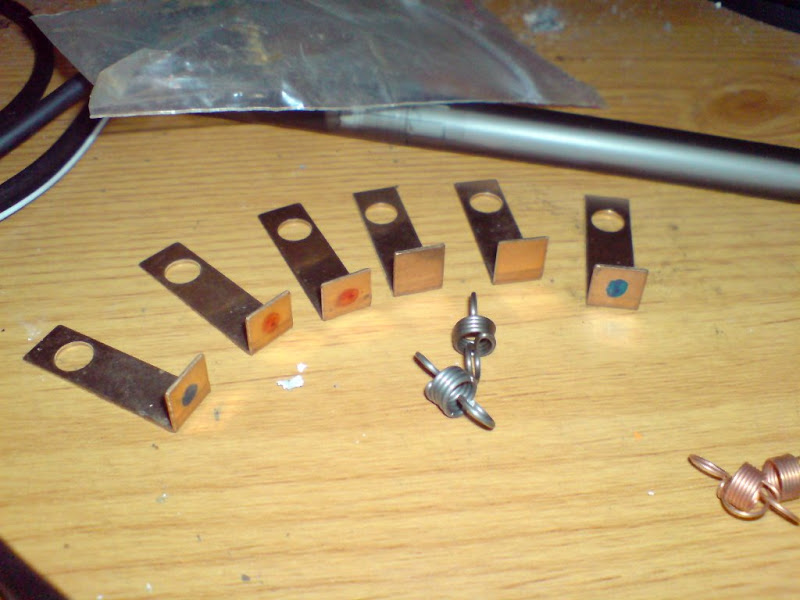

thanks for the ideas. next thing i'll do will definetly be to restrict the advance, so they won't go past 36
i'll try the lighter spring as well to have it kick in earlier, but will check on the centrifugal advance and ho i can limit it first

I FOUND THEM !!!! those bloody spring and lock set. 3 hours searching, well worth it. i'm excited to try them tomorrow, just download the manual to see what each of them does. the great thing is I can limit it to 36, no matter what springs I have and then fool around with the springs to curve it with a fixed max at 36 :-) happy days
