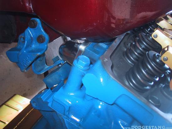

Allow me to restate
Do you have photos of your 351c installation in your 65/6 mustang using the later 65/66 mounts you pictured above so that I can see where I might have been mistaken when I was unable to complete the same installation in my own car. I used early 65 mustang/64 falcon 3 piece motor mounts to make it work and was able to install the motor without dented my shock towers as was defined being required in the article you linked previously.
3 piece mounts I used:

You've managed to completely confuse me...so I'm sure the original poster is confused. If you had less post count at this point I might even thought you were being a troll or otherwise being intentionally obtuse.
I will re-iterate my statements from experience.
Yes you can install a 351c in a 65 mustang, to do it in my own car I used:
64 Falcon/Early 65 3 piece motor mounts
Ford Power Train headers
Drop base air filter
Torque strap
I did not dent my shock towers. This is a proven installation path.
Others may say "Ohh you can't do it" or and this is a first "ohh you can do it just fine with 66 mustang mounts" - my experience differs on both these instances. The mounts are designed different, they physically hold the motor differently. Whether or not the motor ends up in the same location, the mounts hold the motor differently and are lower which enabled me to install it in my car with my header selection without making any shock tower mods.
I won't argue semantics about "specs say this or specs say that" these are the mounts I used to put it in my car. You say I can use others because they are all the same...great...show me. Have you installed a 351c in your car or not? Do you have a picture of it in your car with the 65/6 mustang mounts so I can see it? I had those mounts and I tried to install with those mounts for quite some time, they did not work for me. Then you tell me it should fit better for me, to jack my towers and install bracing? Did you bother to look at my photos where I have an export brace and monte bar already installed in the car? Braces that dropped right in with little effort? I do not have shock tower sag, I do not have some flex rusted out POS that you have to jack things apart to make bolts work, I can change the front and rear tires on my car with a single jack point.
You also answered the original poster's question with a link indicating it would have all the info you need to do the installation. The information contained in that link clearly stated in several locations to 'sledge hammer the shock towers' which is something I opted to clarify for the sake of the original poster, it wasn't until several post of back and forth you have even mentioned something along the lines of "ohh and yeah I would dent my headers before the shock towers". So is the point of this exercise boiled down to:
I say you can do it without denting shock towers but you have use falcon mounts and you say you can do it without denting shock towers but it doesn't matter what mounts you use? If that's the core of the argument I believe experience and documented evidence is the only path to resolution. I've shown my successful installation can we see yours?
