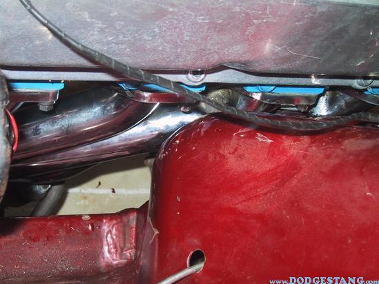

Quote:
Originally Posted by 2+2GT View Post
Why does everyone keep telling him to use Falcon motor mounts? The 260/289/302/ AND 351 all use the same motor mounts, therefore the stock 65 Mustang mounts will work perfectly. Now if he wants something stronger, aftermarket racing style mounts, for the 65 Mustang, will also work perfectly.
For 30 yrs through word of mouth at car shows, magazines, and what not, if you asked someone "Can I install a cleveland in my 65" the stock answer was "Not unless you cut back the shock towers". Then the internet came along and these folks got to say it to an even larger audience and put together pages of 'information' that contain some things that are correct and other things that are not. Thanks to a few people who never listen a combination was put together that enables a person to bolt the motor into the car without doing anything to the shock towers as your link article recommends. Motor mount selection is key in the equation as well as header choice.
The 64 falcon motor mounts are the same ones used in early 65 model mustangs and have a 3 piece design. I am telling him to use them because I know that they alter the position of the motor slightly lower than the later 65/66 style mounts making it easier to install the headers on the motor.
I also recommend against using those tubular auto headers with the cross over design. They where in my car when I bought it and the fordpowertrain are a much better design, fit better, and allow the use of the front cross member (which had been removed from my car when purchased because of interference with the cross over tubes).
You will also notice I run a torque strap. While the motor fits and the towers are stock, I would never profess that it isn't tight I have less than a 1/8-1/16th to the towers with everything bolted up and in place the headers would contact the towers without a strap to limit motion.
