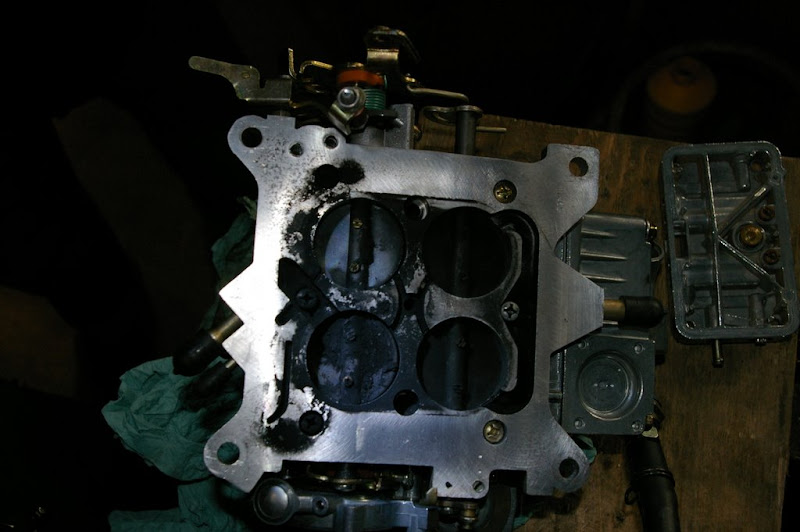

just received the pics from him ... amazing ....
here's 2 more of the cleanup job ahead ...
http://picasaweb.google.com/schlauch/Pepe#
any plans? block that stupid thing off or will that just cause other problems (postive pressure somewhere else) ?

Ah, mystery solved. That's the wrong gasket. The 70 used a unique gasket. Glazier Nolan can provide them.

Blocking it with some screw in plugs after tapping the holes would allow you to use any gasket, otherwise its going to need some metal over that part to keep from burning stuff up. The 70 gasket should have a gasket with metal on at least one side for that application.
That could be very useful for picking up mileage with ethanol, but keeping it from boiling out of the carb at 174F would be the trick. There is more to it, and I wont get into it here, need to check my manifolds and see if any have that port in them. Never paid attention to it before.

yeah kalli you can block off those holes they just lead down to an exhaust port on each side of the motor. hell, doing it on the bottom of the intake would be even better cause it would keep some of those higher temps farther away from the carb. (in theory)

yah. i said to him I'll discuss with you if we can block it off, but before I even got back to him with that (i was gonbe for the weekend) he phoned and said that he took too little pipes, drilled/tap screw blocked and pressed them in. job done. he's a machinist, so I think he couldn't hold himself back :-)
I prefer to have the manifold/carb as cold as possible anyway
anyway I'm glad we finally found the problem. He's nearly finished cleaning up, we got him a new powervalve. so I think he should be good to go for another start.

once it was all cleaned up, the intake blocked, new gaskets she started straight after the fuel bowls filled up. the engine was idling near 3000 since that was wherew the butterfly for idle was set to have it half way running in "idle" would you believe ... anyway with 8 degrees advance she'd hesitate starting, so i brought her back to 4. it's better but you can really hear the stressed started. the selonoid is near mush, so we'll replace that tomorrow. if that doesn't help I'll retard a bit further..
