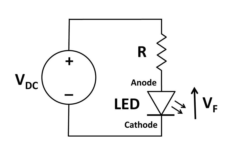

All a resister will do, is turn that power into heat. A BIG resister doesn't
mean anything, that usually means a 55watt -vs- a 35watt which it will
work better for keeping the LEDs from illuminating. The problem, is, people
put them in SERIES with the + wire, severely reducing power to the LED.
They go in PARALLEL:
Wiring it in SERIES makes it current limiting, not a load.
This will DIM the LED, but also protect it. When LEDs heat up, they want more current, which is what
pops them. Using a current limiting resister keeps the current flow at a fixed rate, and it can't pull more.
It results in a dimmer LED, only if you don't match it with the right resister.
