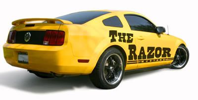

Old 07-02-2011, 01:15 PM
Forton
Forton's Avatar
Join Date: Jun 2011
Location: KY
Posts: 3
.....Pics of my Mustang. For you Razor so you can see it happened............... Regards,Forten

Old 02-28-2012, 06:54 PM
sofaking5.0
sofaking5.0's Avatar
Join Date: Feb 2012
Location: NC
Posts: 57
^^ Beautiful mustang!!^^
