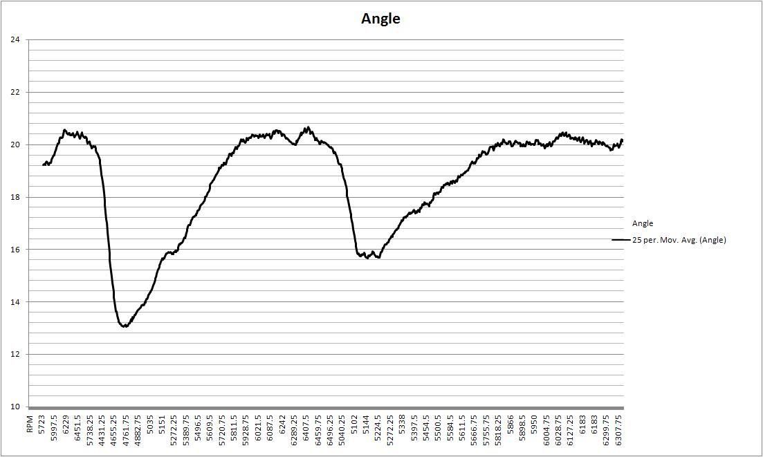

2. Datalog your cam angle if you could, I'd like some comparison to mine. Here are my results
We can see, that even though the tune is set to a MAX of 20, it will casually stray up to .8 degrees above.

I guess if I do a data log with my SCT X2 it will pick up the cam angles? Speaking of which, I wish SCT would start supporting 64 bit Windows. It's really annoying that my new notebook is 64bit and my main PC is 64bit and their drivers do not like that.
