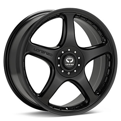

The drivers rims are trashed, so I'm thinking about swapping out my Lorenzo WL28s for some XXR 535s (opinions?)

I like the Lorenzos better personally but only because the XXR's look a little plain. However your ride alreadyseem to have a fair amount of bling so maybe that will look good that way. Either way you can't go wrong.

Yeah the car came with the Lorenzos, wouldn't have been my first choice but I have no complaints with them. If I got the XXRs I would get some polished extended lugs to accentuate them a little better.

Haha, I like XXR for the opposite reason, to me the Lorenzos look busy.
Either one will look good however and compliment the white nicely.
