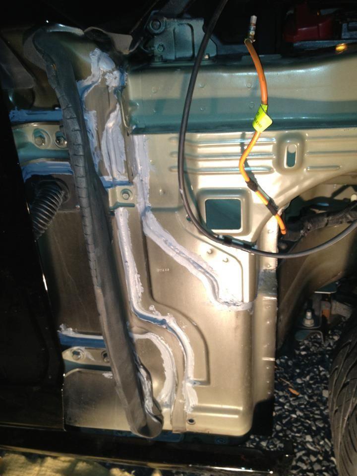

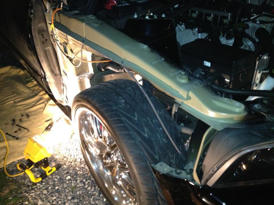

Someone on this forum posted these pictures, jeez must be over ten years ago now, in one of the various similar threads. From what I remember this resolved the problem, hence me saving the pictures. My 2005 and 2009 both never leaked.
Good luck!

What I am cutting? It looks like the from the picture above that it just unbolts. No?
Is there any wires or other things in the fender I need to be aware of? (besides what looks like the antenna and wiper fluid tube)
The leak comes from what appears under the dash and after long rains or hard ones I can turn and see it pour out a little. So I don't think I need to worry about it going the full length like in the photos.
