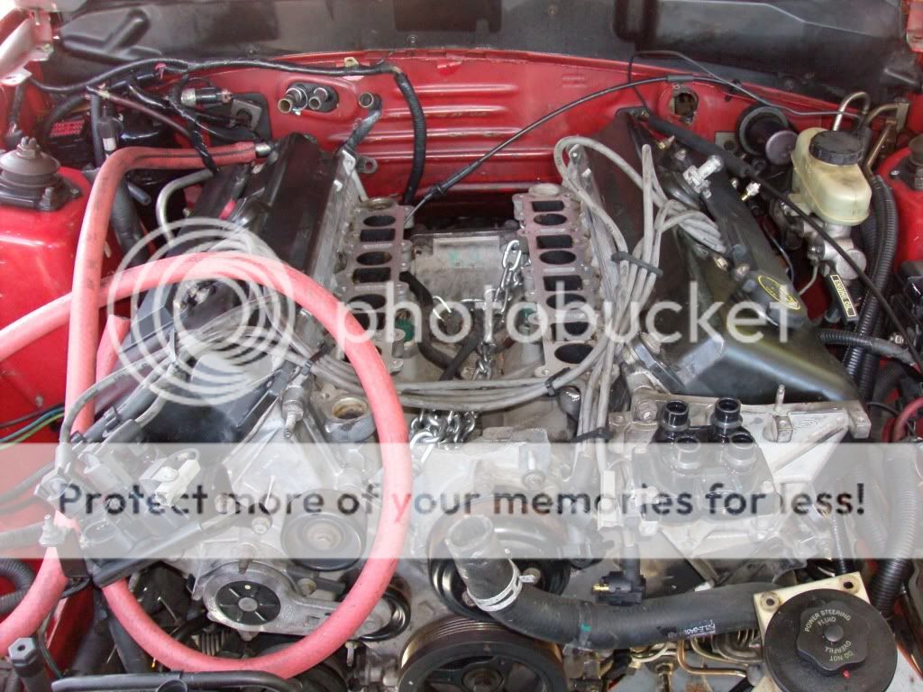

Put B heads, which are 32 valve, which require a different front cover and timing chain setup, and you could use it.
I assume you know what the intake ports on your head look like?
These are B heads:
Note how each head has 8 ports....your GT heads only have intake port per cylinder.
I don't have a picture of the heads from my junk 2v engine, but they are kinda like a boxed shaped teardrop? You could find a pic of them with a quick Google seach.
tl;dr version: not even close.
There you go, sorry to burst any bubble you may have had in regards to this :P.
