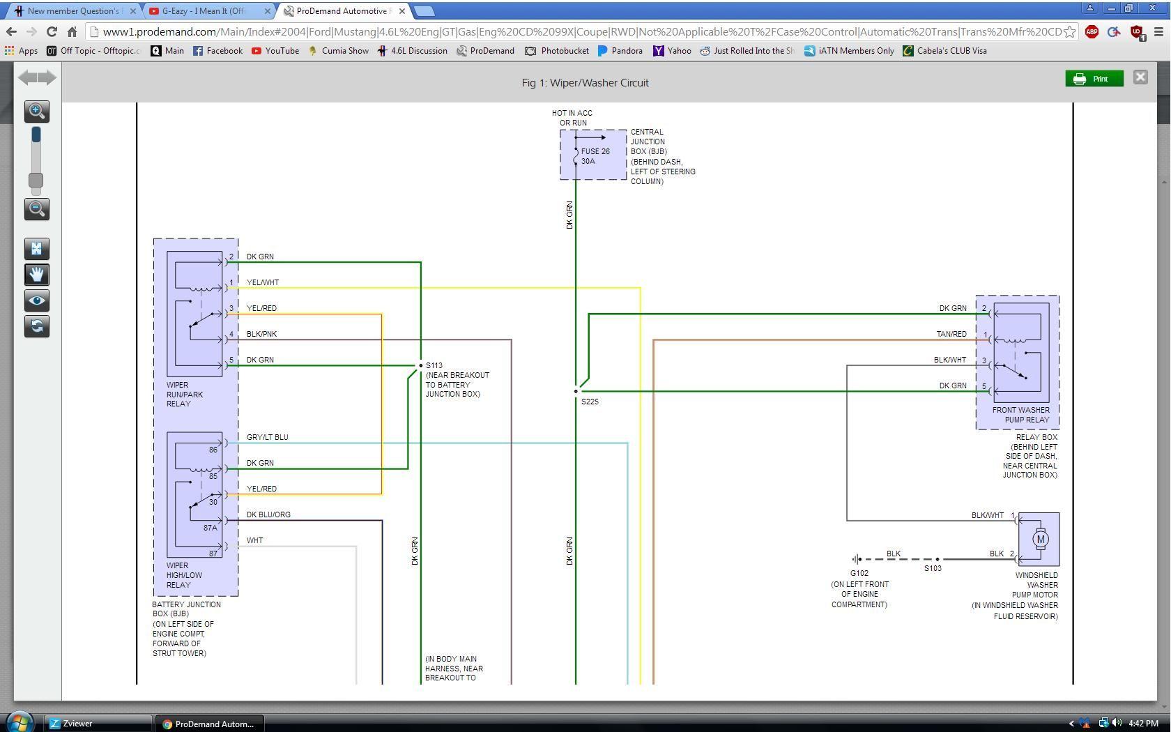

Concern 2: my windshield wipers don't engage the motor for the spayed engages, I've tried to look for the diagram of the fuse under the hood and inside of the car under the steering column. I couldn't find the right diagrams for both of theses areas.

#2 so you have no wipers at all? but the washer fluid sprayers work?

heres you wiper diagram.. check fuses, then with the wipers on try accessing the motor and giving it a nice solid smack to see if the motor froze up. watch your fingers! If obviously that wont work its time to start checking powers and grounds

For the Question 2: the wipers don't engage only thewindow sprayer wirks I've looked at the main fuse box under the hood I see that I am missing to relays if there's four relays for the GT. Looked at the fuses under the steeringcolumn do I count the fuse til I hit fuse 26?

Not every fuse receptacle is meant to have a fuse in it.Unlikely that someone would remove a fuse,but from my brief time on the forum reading about strange problems,I'm not surprised at the so called "improvements" or "mods" that get rendered upon the poor Mustang victims.
To determine the fuse number,look at the underside of the fuse compartment lid for it's corresponding location.
