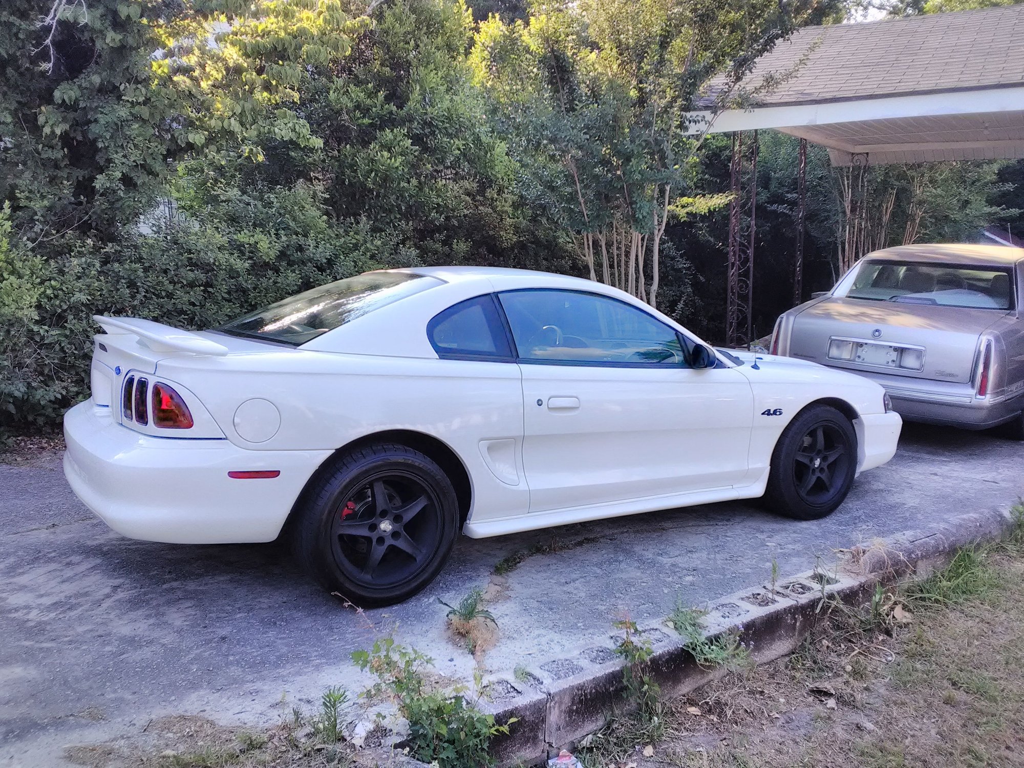

I went to pick up my car yesterday (1997 Mustang GT). It has 3.73 gears which have never given me an issue. It has a "short shift" shifter which has never been problematic. My bearing retainer was broken and chirping which led to my throw out bearing going bad. I had a new clutch installed, throw out bearing, pilot bearing, and throw out bearing retainer tube (the stock one had broken at the bell housing.....it's the kind that is pressed in from inside the bell housing. Anyway....... when I picked her up, I immediately noted that there was a very loud whirring/spooling sound coming from the area of the clutch (sounded like a spaceship) and a "knock/rattle" from the area of the transmission (almost like when you are teaching someone to drive a manual and they try to start off in too high of a gear). The "knocking/rattling" noise was off and on, and very noticeable when just barely moving like when you are in first gear and release the clutch to get moving. There was no vibration in the pedal or shifter. I also noted that the clutch pedal was super soft. I made it about a block before i decided to turn around and take it back to the shop. The noises got louder as the rpm's and speed increased. The mechanic drove it and said that he heard a "chirp" which he said was the new pilot bearing needing to be broken in and that he also heard something "odd" from the transmission. He said that "maybe" it needs to reseat itself or "maybe" something inside the transmission "shifted".
I know that he sent the transmission to a "transmission guy" to have the TOB retainer (quill tube) replaced and I know that in order to do this, the bell housing had to be opened up. It took about a week for this to take place since the part was difficult to source. So, the mechanic says "drive it this weekend and see what happens.....worst case, even if you mess it up, the transmission work is under warranty". He literally had no clue what these noises were. So, me being dumb to the world of mechanics..... I got in my car to leave and follow his advice. Low and behold the after backing up his driveway, I couldn't get it out of reverse! I'm not sure what to do now.....should I take it to another shop and tell him to get screwed or should I let him keep my car for another 2 weeks to "fix" it. I am physically sick to my stomach over this ****. I had to take a Zoloft to calm my nerves (prescribed).
Now I turn to you guys/gals. Did this shop royally frig up my car or is it normal to have such odd sounds after a clutch job????? I don't know what to do next or where to turn. Thankfully I do have access to another vehicle for transportation but dammit I want my mustang back! I'm almost to the point of saying "to hell with it....I'm selling it". But..... who in their right mind is going to buy a mustang gt with a potential transmission issue??? NO ONE! I wish I could upload a video but the car is locked up at the shop and the guy is out for the 4th of July holiday. WHAT WOULD YOU DO!?????
