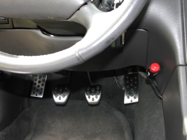

the install wasn't bad at all. I used vaseline but my brake pedal still gave me a little trouble, I think b/c the water started to cool off. I boiled the water again and started on the gas pedal while the brake pedal soaked for a couple mins.

Well many years ago I did the gas pedal mod, and I noticed when swapping the pedals that the nylon spacer had shifted and throttle cable had slipped through part of it. This would explain why I've had to adjust my WOT switch just to get it to spray. Well on the install I centered a small hose clamp on the nylon washer, my gas pedal is much higher, throtlle response is amazine and the car pulls much harder (even NA on my N2O tune).

love mine, they deff look good. give the interior a nice touch IMO.
and 01GT that is a interesting place you put the shift light.... do you like it there? easy to see it light up? im thinking about getting one like that soon.
