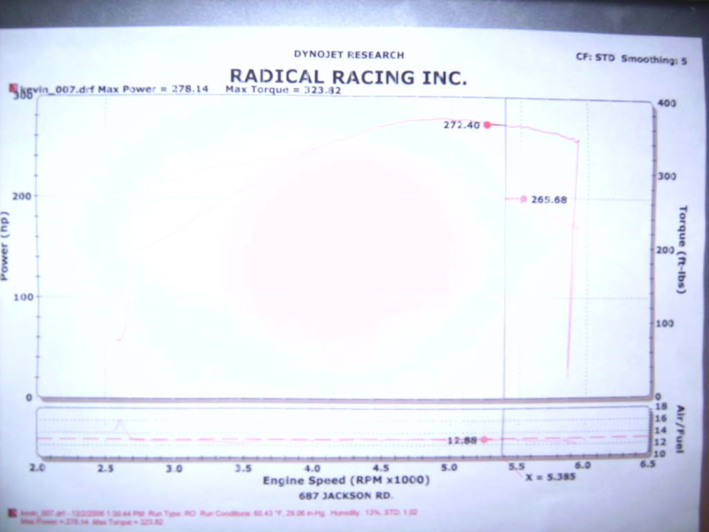

Kmelfi11
Join Date: Dec 2007
Location: New Jersey
Posts: 1,787
Quote:
Originally Posted by huey_33 View Post
I did put the shift points back to original lastnight before my second run. Car shifted fine and I don't think it hit 7000rpms. I forgot my camera to mount on the steering wheel so I will see next week. In the meantime, I am just going to order more tunes from Bama and request they set my shifts at 6000rpms. Maybe I didn't do it right with the tuner when I tried switching my shift points.
this picture is shi**y and if I was home I could get a better one. This is my dyno and you can see the power dropping after 5000rpm. I shift at 5500-5800 depending on the gear and its for traction into the next gear. not only will you run slower shifting higher then 5800-6000 but our engines aren't built for it.
