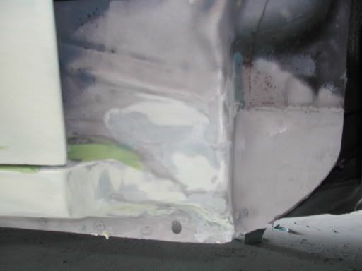

check the floors in the front... as well as torque boxes... and where the kframe meets up with the strut towers... all those places rust like a ****
oh.. rockers too... you dont want ones that look like mine when i took the front fenders off :
because it takes lots of welding to make that look like this:
