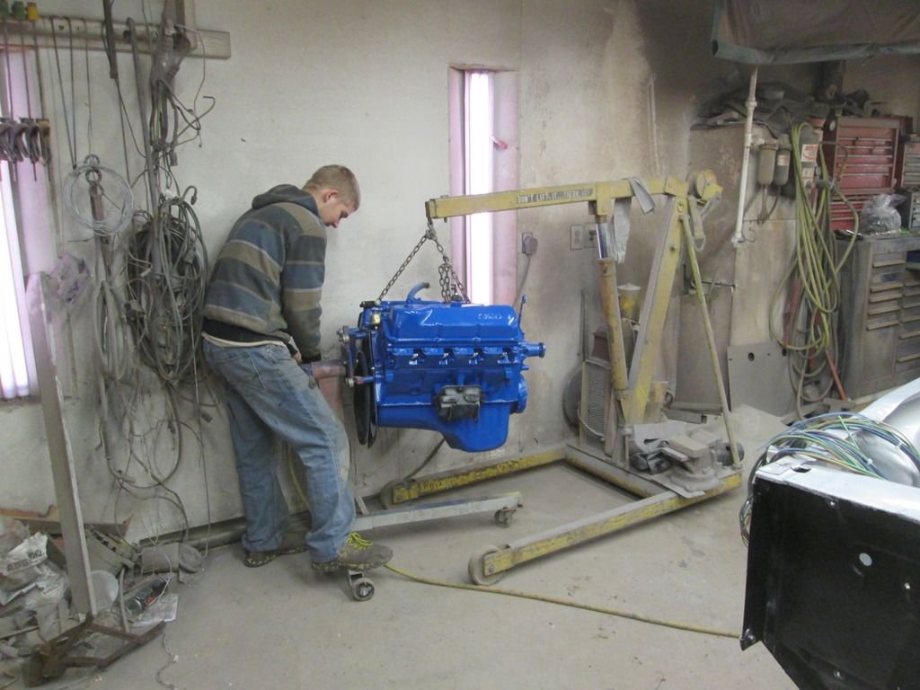

Hasn't been much to report on as last week was busy with Scouting activities and this weekend is too.
Last Friday we did bring the car back in the shop and worked on it Saturday. We removed the hood and fenders and set the motor in place to check clearances and the trans linkage. (the trans shop gave me the empty housing back with just the lever installed so we could easily lift it into place).
We found the shift lever would hit the floor pan, so we are going with a Lokar shift lever and removing the stock one.
I made the boy get everything set up to install the motor while I assisted him. After all it is his car and he needs to know how everything goes together that way when something happens and dads not around he should be able to remove and repair it. Key word there is Should.
Removed the hood and fenders to not damage them putting the motor in.
After attempting to set the motor several times and modifying the motor mounts and driver side manifold, then diggin in my shed to find and older passenger side manifold because the one from the Ranchero was to fat at the flange and hit the frame rail. We finally got a good fit (tight but good).
Didn't have any pics of how the tranny fit, but that wasn't very exciting anyway.
So at this point the motor is still in the car, the hood and fenders are back on to save shop space, and the tranny is back at the trans shop awaiting it's turn in the build process.
