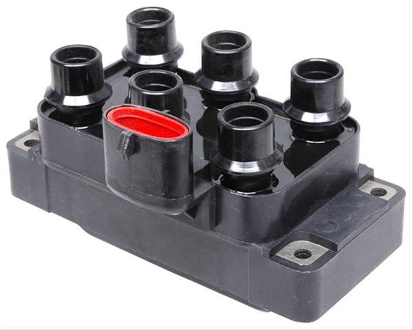

FYI, you have a coil pack.
AND, there are only three actual coils in the pack for the 6 cylinders.
4 & 3, 6 & 2, and 5 & 1.
So, when plug 3 fires, so does 4, and so on. However, 4 may be on the exhaust stroke when
3 fires, so you still can't mix the wires up, because when 4 fires, so does 3, but 3 won't be on
the compression stroke.
Yes it is coil pack. Thanks for the response and the details. I’m debating which coil pack to get ? The OEM or an aftermarket one ?

There's no advantage to going aftermarket unless you have a built motor. Even then, the OEM will be the most reliable.

Default I’m having hard time finding OEM coil pack reasonably priced. And in the mean time
I’m having hard time to find the OEM ignition coil (Motorcraft) or when I find one is like $150. I’m afraid of buing the cheap ones too. Is there one you guys recommend
that is working for you and won’t break the bank ? Thanks guys !
Being that I'm working on a different vehicle and replacing some rod bearings, it got me thinking as to other sources of knocking. Where is your knock sound coming from? If it's from the Oil pan area, it could be rod knock as in you have a rod bearing that's worn out or spun.
How's the oil level and condition look?
Oil looks good. I’m replacing the plugs and wires with Motorcraft OEM. Next I’ll put a new coil pack but I’m having hard time finding the OEM reasonably priced. Do you guys have used any aftermarket that you’re happy with ? Thanks
https://www.rockauto.com/en/catalog/...tion+coil,7060
any of them in the standard section from the Delphi on up. I wouldn't use Airtex or United Motor. The others are all OEM suppliers for various manufacturers (except for the Beck Arnley which itself is a rebranded one).
