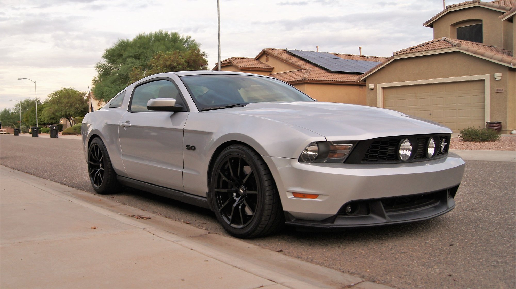

Hey guys, this is going to be a build thread of sorts for my Mustang. I've had her for exactly a year, and have just recently decided to go ahead with modding. I picked up this 2012 Brembo 3.73 car with 24k miles on her on July 4 2016, looking just like this

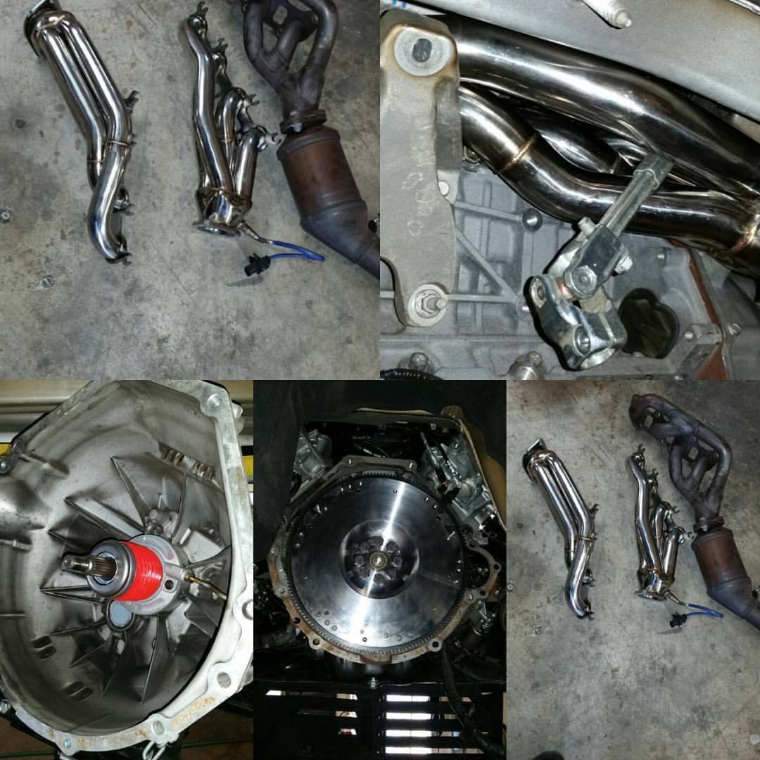

Already had a change in my plans. Been hearing a lot about corrosion problems with BBK headers, so lucky for me I didnt have them installed already. I found a set of 304 stainless with 1-7/8 primaries for a steal.

These are the 304 stainless headers I got to replace the BBK, even came with metal gaskets better than the BBK.

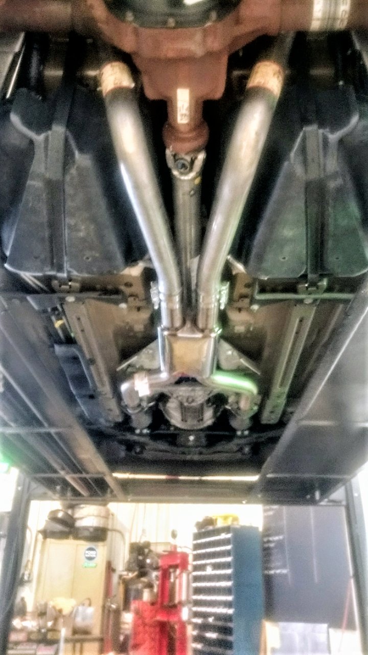

Got my car back from the shop, so I had to finally take some good pictures! I love how the car feels now, it is so much more visceral. The only knock I have is the driveshaft wines above 50 mph, which my wife immediately hated . The solo exhaust really dose have zero drone, but is still loud and throaty while accelerating. The stance with the K-springs is now perfect!
