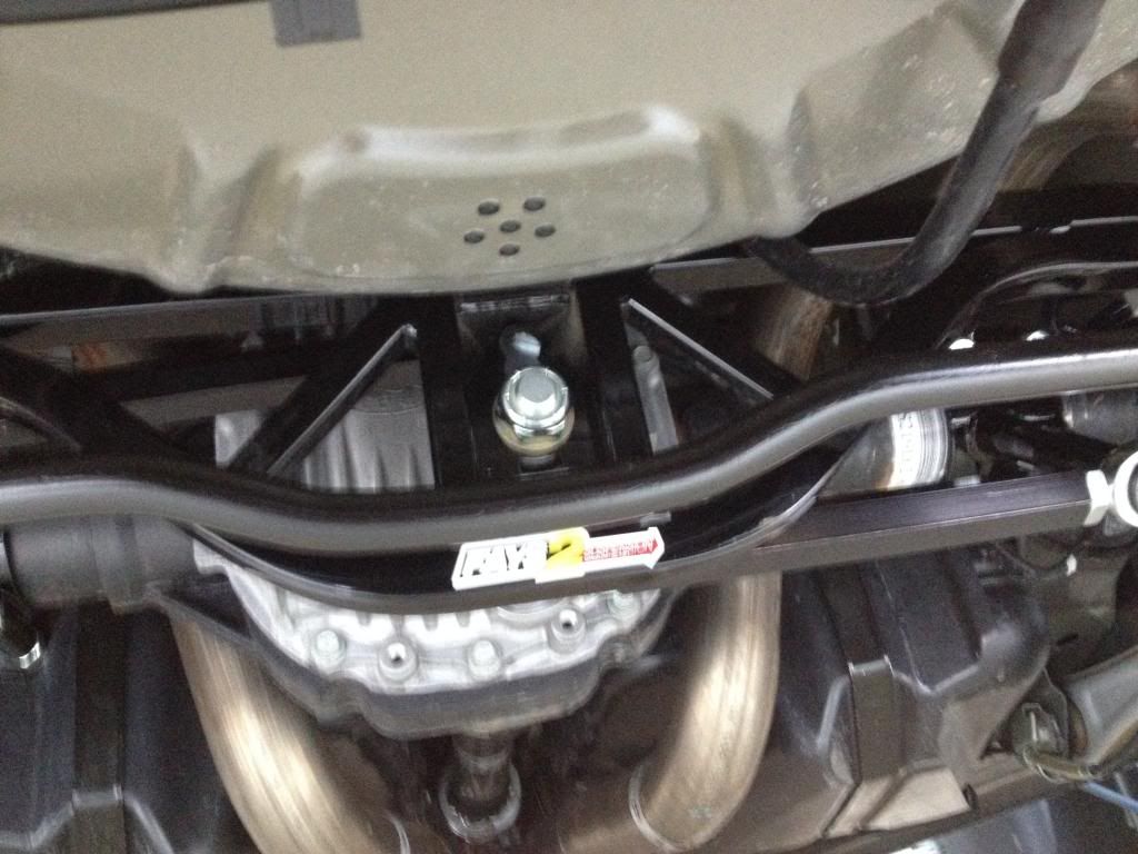

My goal was track day improvement not a lower look. Went with the Steeda Boss 302 springs, Steeda HD plates, Koni Yellow, Ford Racing jounce, Fays2 Watts Link.
The springs and struts were a piece of cake to install with the car on jack stands. The Fays2 requires careful measurements. In the end I had an issue with the axle not being centered. A call to Jim, owner of Fays2, got a quick resolution to a problem he knew immediately. Jim said, "did you do the install on jack stands instead of weighted on ramps"? Yes; I did the install with the car on the jack stands due to wanting clearance due to my Track Pack finned differential cover. The unweighted install created the axle issue so I dropped the car onto the ramps, loosened the axle clamps, re-centered the car, tightened up and perfect. Thanks Jim.
I chose the Steeda HD mounts as I was told with a struts and springs set up the max negative camber of -2.3, without interference, was obtainable with the HD so a more exotic camber plate would be a waste.
Also installed the 2013-14 model JLT Brake Cooling kit. This is a very nice kit for a reasonable price. Install was a bit of a pain but not difficult if care is taken locating the holes you must cut in the lower fascia. You can see the intake in the lower fascia of the top photo.
No driving experience yet as the roads here in Northern NH are a mess for a while yet. I will report back once the car is on the road and again after my first track day; May 9.
Very pleased with all the pieces. Steeda customer service was exceptional. The Mustang aftermarket is highly competitive and everyone I have corresponded with and bought from has been great but Steeda's follow up and responsiveness was astonishing.
[IMG][/IMG]
[IMG][/IMG]
Now that I think about it I'm not sure if I measured my axle offset after I completed my Fays2 install. I installed mine on jack stands as well so I might need to double check it.
