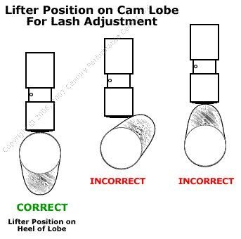

What you'll want to do is pick any valve (start at the front for ease i guess) rotate the engine over by hand until the valve closes. keep rotating the engine and attempt to rotate the pushrod like it were a drill bit and you were trying to hand drill something. with the lifter sitting on the base circle you should be able to rotate that pushrod with little effort but it should not have noticable up and down play it should be snug but not bound up either.
The rocker arms on the I6 appear to be captured on that guide rod that makes me think push rod length it quite critical even more so than with a v8 setup. Especially since I cant see a way to adjust them. Im guessing they will feel bound up and very tight
here is a picture of base circle.
