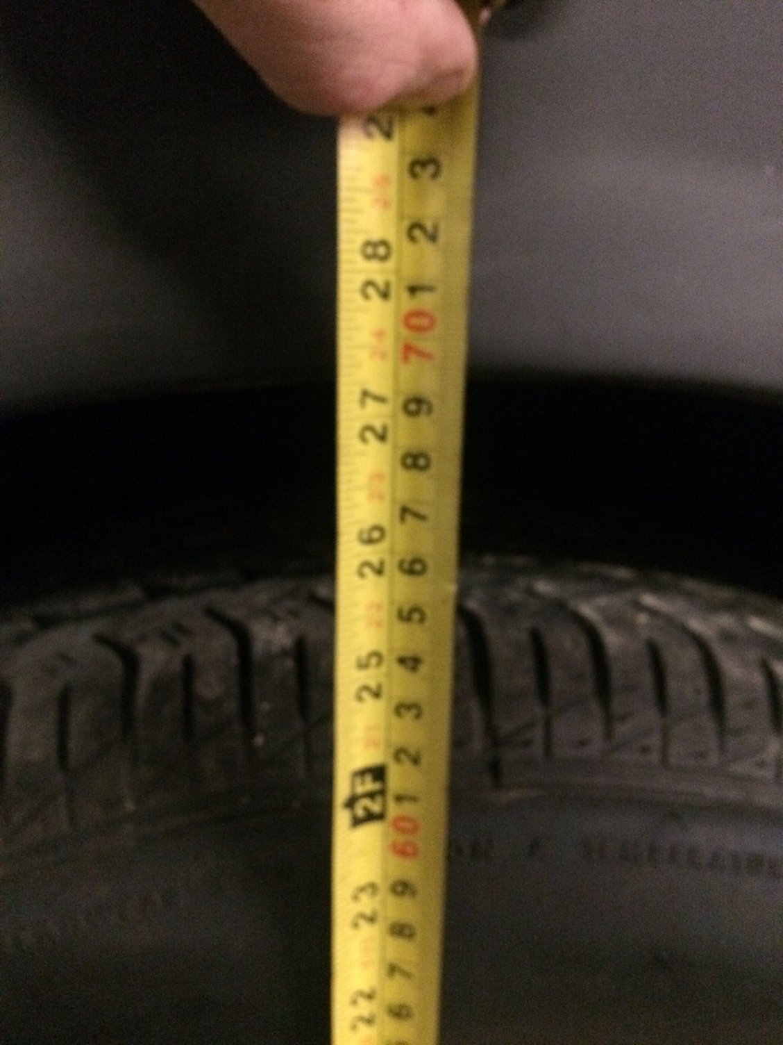

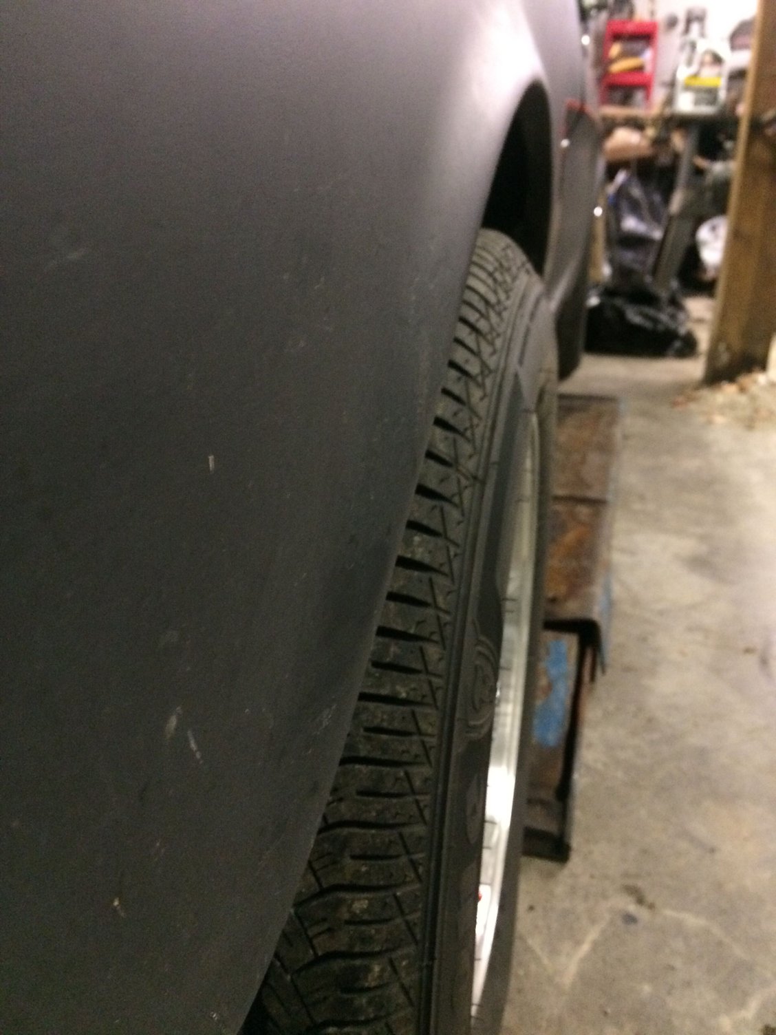

My 8 inch rear end was a happy accident because my tires actually stick out further than my old rear end. Maybe not a 66 rear end? That's fine. I love the look, however I fear that once I eliminate my air shocks my quarter panel will touch my tire when I go over a bounce on the highway or on the back roads. I will post a picture from my phone to show where my tire sticks out.
When measuring my ride height with my shocks at 25-30 psi (where I have always kept them) I get about 28.3 inches from the ground to the highest point of the wheel gap in my quarter pane/rear fender. When I let it down to 0 psi I get about 27 inches. Will this be my ride height once I eliminate my air shocks and replace with another shock? I know springs affect ride height, but air shocks do, too. When I bounce on the back end of my car I still do not have contact even with 0 psi, but will regular shocks drop my height even more? I have new leaf springs and shackles, less than 2 years old.

I would let all the air out of the air shocks and see how far the rear end drops lower.
If the rear end dips a lot your gonna have to look at other options.
Regular shocks don't do much for raising up the car.

It looks like you have plenty of clearance between your tire and fender now so if you go with say, a stock ride height spring and your tire isn't too oversized then you should be just fine. I kept the stock ride height spring in the rear and did the Shelby drop up front and it gave it a nice little rake. Probably not optimum for corner carving like Jams but for daily driving it did just fine.
