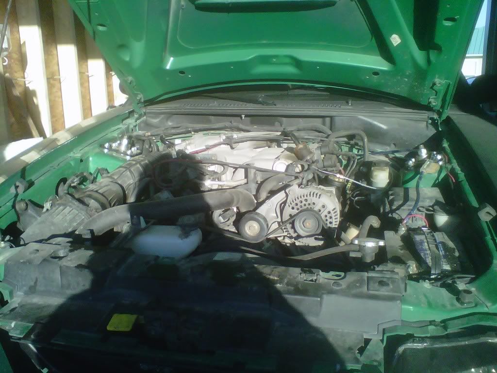

Finally an update for you guys... and its pretty big:
Just a pic of the engine.
Hoodless!
Air intake removed.
Disconnect all connectors/vaccum lines associated with the upper intake.
Coil pack removed along with a couple vaccum lines.
upper intake removed.
fuel rail removed. Be careful for dirt around the injectors. I didnt have a nozzle for an air compressor so I just used a screwdriver and vaccum.
stock injectors removed and 39ers put in their place.
Just to show how the injectors are held onto the fuel rail.
I broke 5/6 injector connectors, the little tab that holds the connector to the injector. Should I just double zip tie them to the injectors until I can get new connectors?

Good progress.
Take a wet rag with some cleaner on it and clean that harness!
Another thing you could do is put duck tap over the intake ports and plug the injector holes then degrease the entire engine.
Of course, tape off all of the electrical plugs and vacuum ports.
I Tripple Wal-Mart bagged my alternator. :P
To dry, use a shop vac with a small section of garden hose taped to the end (About 12") and set it to blow and use it as a high power air cannon to blow all the water out.
It worked great every time I did it like that.
As for the broken clips on the injector plugs, mine broke too but they stay down just fine but securing them would be the best thing to do as you dont want one of those losing contact under boost.

I dont care how the engine looks. 4.2 will be put in over the winter.
Im jsut getting it drivable for the car show on the 18th and dyno tune it after.

take the clips off of the old injectors and put them on the 39's, unless that is what you did and they broke.

The clips never broken. The little tabs in the harness connectors(the things you push in to take them off) broke. Im just zip tying them for now. definitely dont want one popping off when Im driving.
