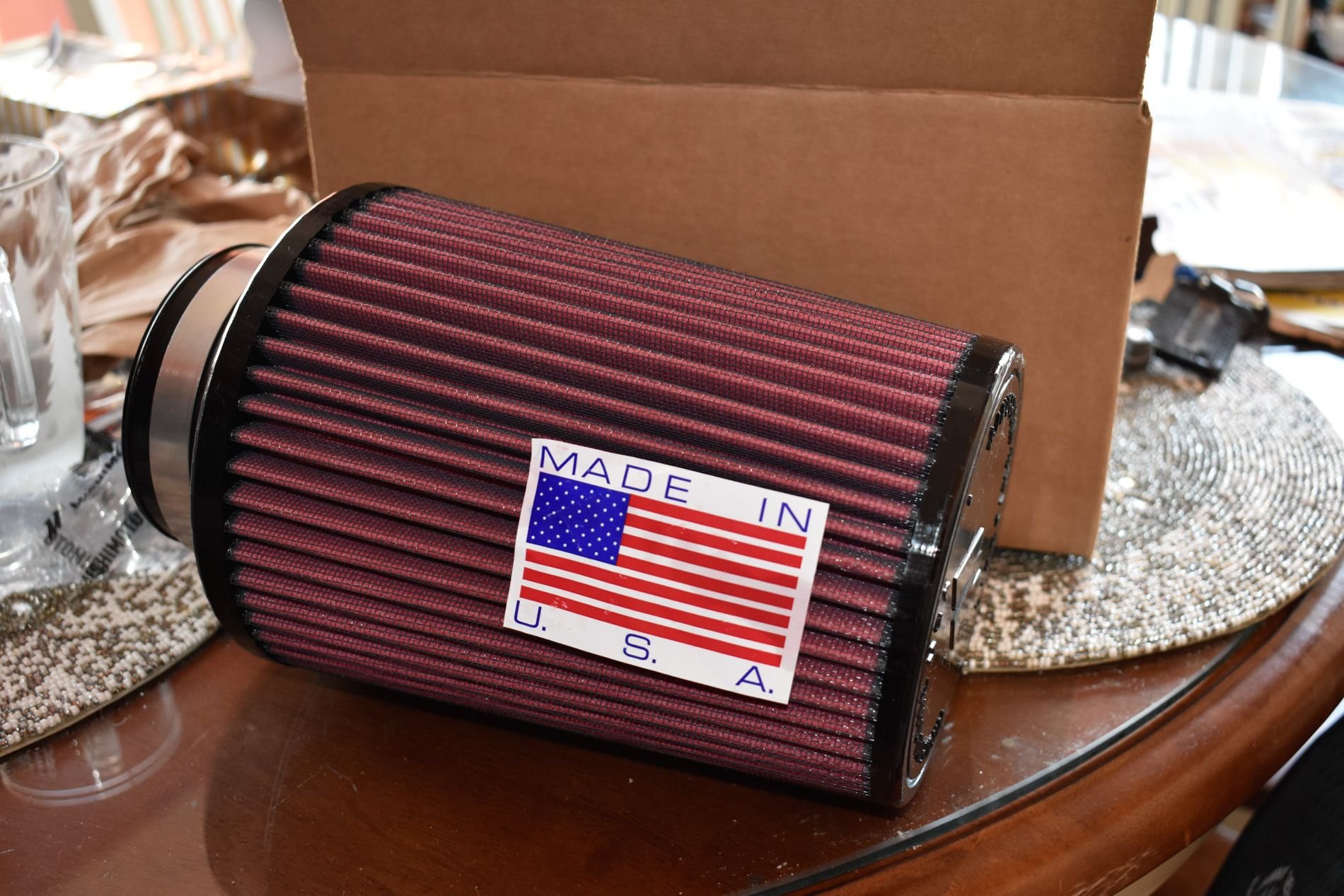

hi everyone i just wanted to give my opinion on the mishimoto air intake. overall the install was very easy and took me all of 20 minutes, you basically just remove the one bolt holding the stock intake on (yes one bolt!)pull that out then go ahead and remove the tube going to the turbo, then the mishimoto box installed next its mounted with a bolt from the headlight houseing, ground bolt (make sure not to fully remove this during install just loosen it to slip tab under) and lastly two push tree clips. then the aluminum intake can be put on next (mmmm shiny) make sure you put on and tighten the air filter on the tube before putting it in the box, then you will install the rubber isolator put the cover on and there ya go! ---- i have a install video on youtube that can help to my page is high low regiment so please like and subscribe to my channel! as well as follow my instagram @high_low_regiment the intake
made in usa filter
