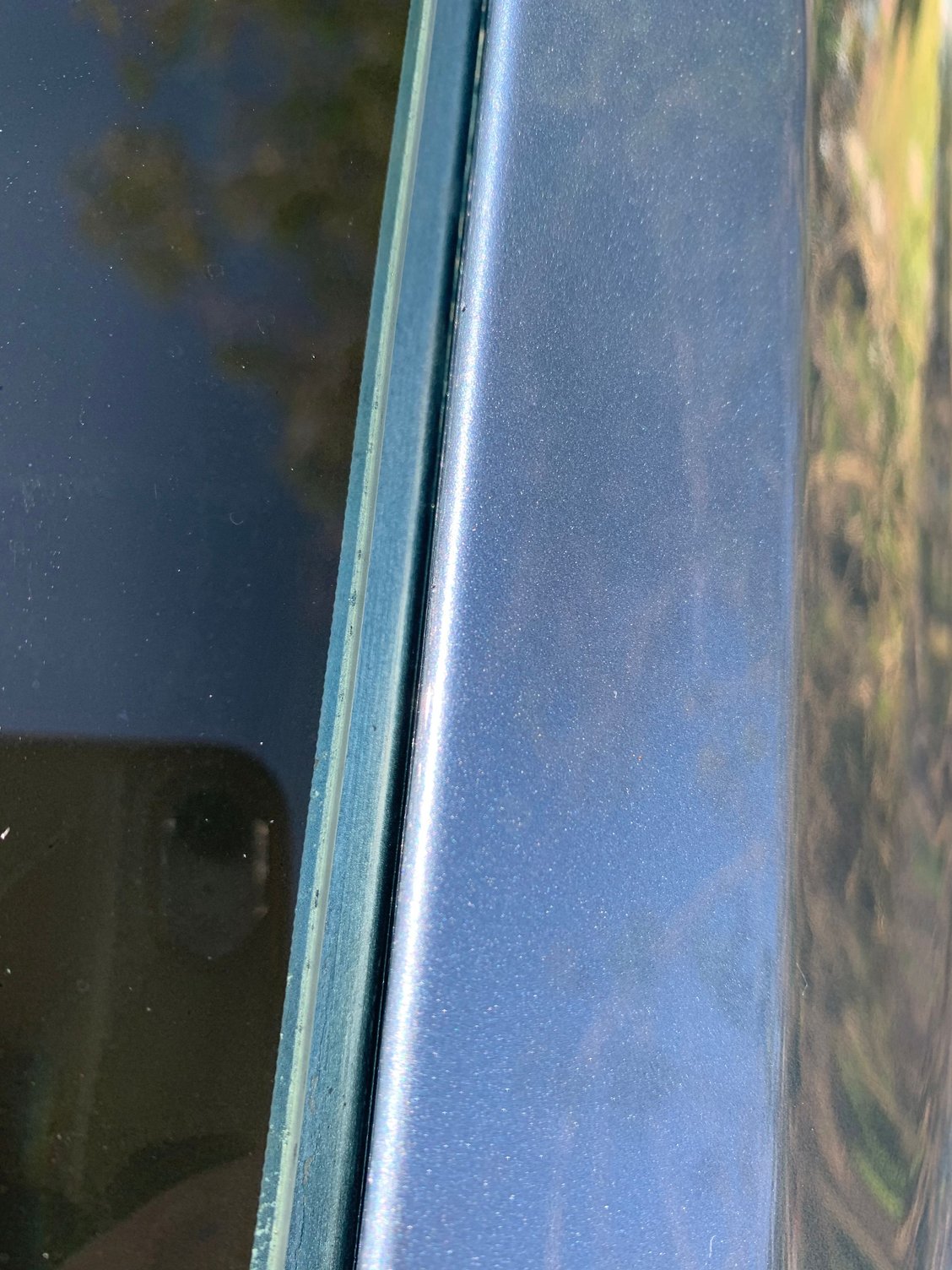

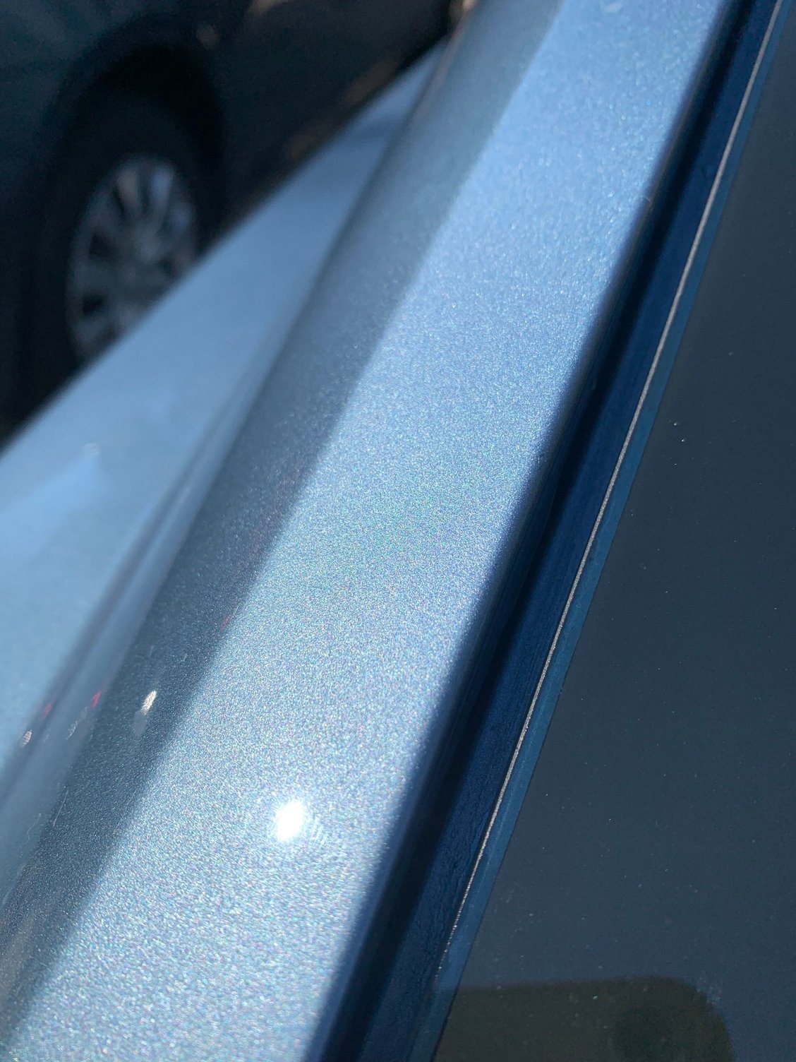

Default *fixed* paint peeling s197 mustang 05-09
I had the same problem on my windveil blue 2007. Noticed after buying unfortunately but I just fixed it and it took less than 30 mins if you don’t count washing the car before.
This was before as you can see all the paint was already peeled off and was starting to get very noticeable... not to only me but to nature as well. This is very important to catch before major oxidization. For this paint correction I used the auto craft ford paint matched pen that has the paint and clear coat in it.
I cleaned out the crevice with a wet toothbrush that took off the rest of the paint that was continuing to peel. Then tapered off the glass which is a must. Unless you want a rear window delete. ( I also did not use the brush that came with the pen due to its cheap Brussels).
This was the final product and I also had put a clear coat on that the ford auto craft pen came with.
