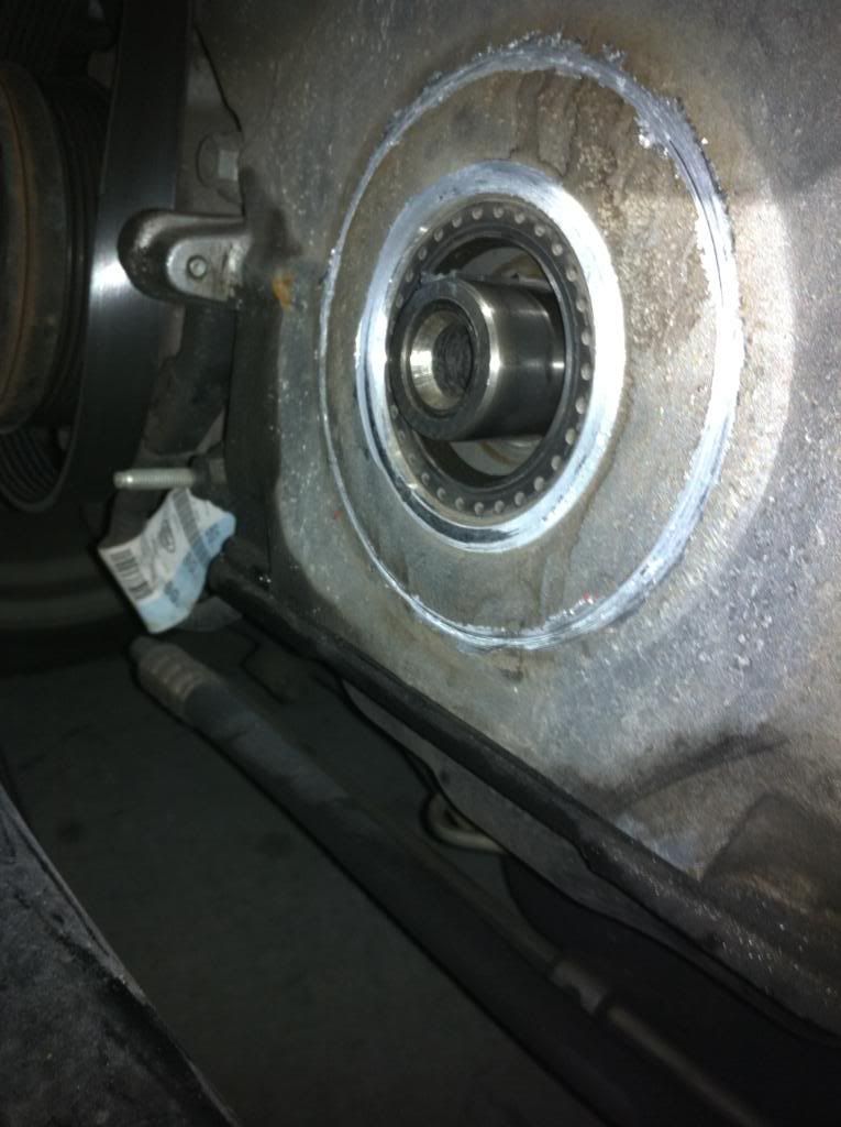

Second problem. After install was complete I started the engine. I noticed some smoke from the UDP pulley area (thinking misaligned belt/chaffing). I shut the engine down. Turns out the back of the UDP was rubbing a nice circular groove in the face of the engine block. So the UDP was very quickly removed to assess the damage. Back of pully is fairly scuffed. Face of engine block has a nice circular grove worn in. It doesn't appear to be damaged to bad. I think its still sound, its just looks like *ss now.

The correct bolt is 340 B. You only damaged the cover plate, not the block so it's fixable. Can you post another pic of the pulley from the front. It doesn't look right.

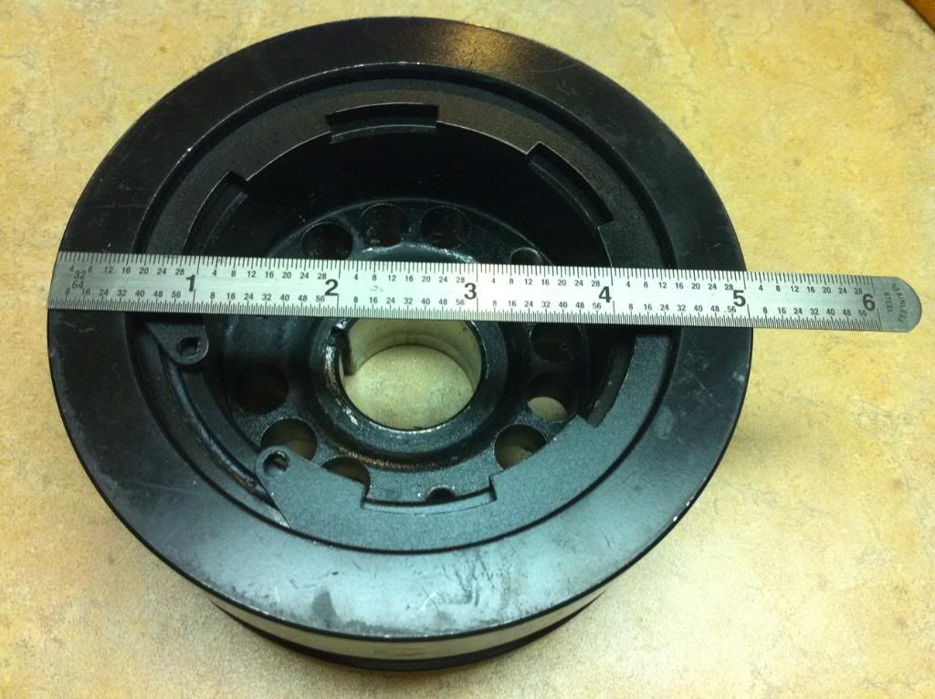

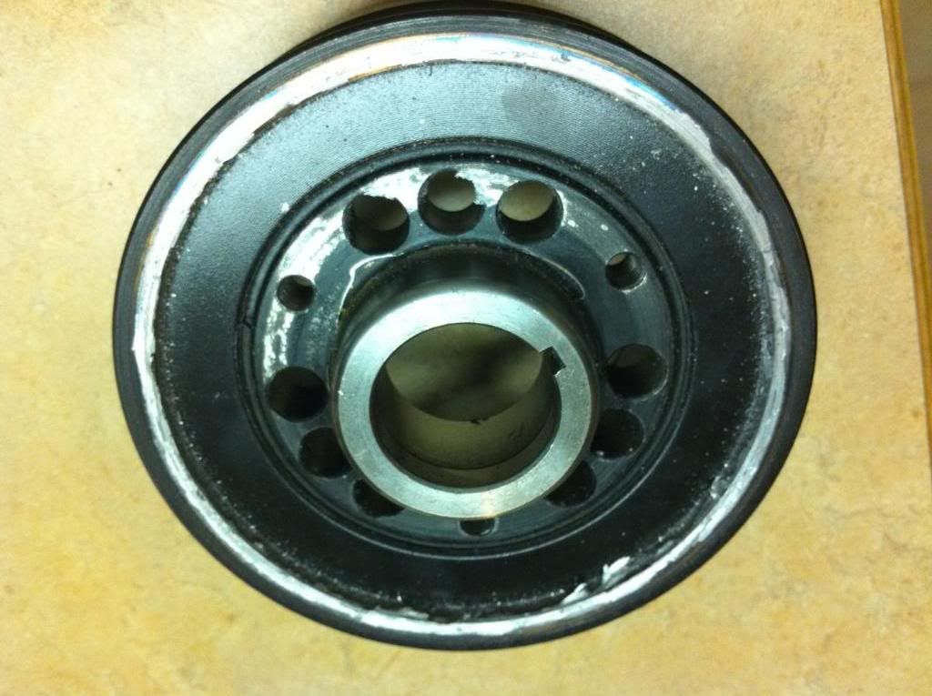

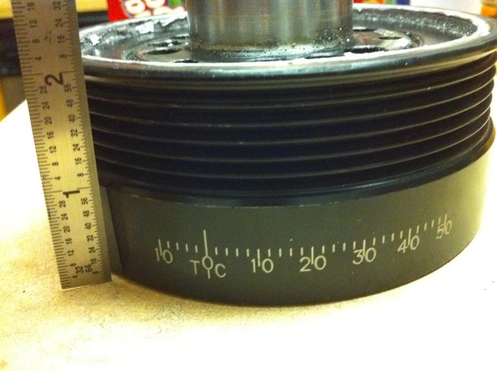

Anyway, here's some pics of the Steeda pulley. I'm very bothered by this whole mess. My crank is sitting barren right now. No pulley. Probably leaking oil. Block is gouged. What a wreck.

That's not the one for a 3v.

Bruce is right. Not only is the bolt wrong but that isn't the right pulley to start with.
This is the correct kit right here:

Its mostly cosmetic, dont worry about it. get a new pulley and your good to go.
