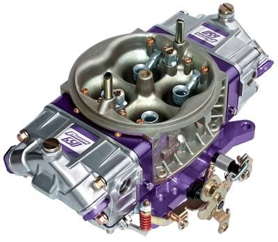

So the air filter connects to the carburetor, the carburetor sits on top of the intake manifold (I am guessing based on the hole in the picture above), which, in turn sits above the heads which feed into the individual cylinders...correct?
Correct!
