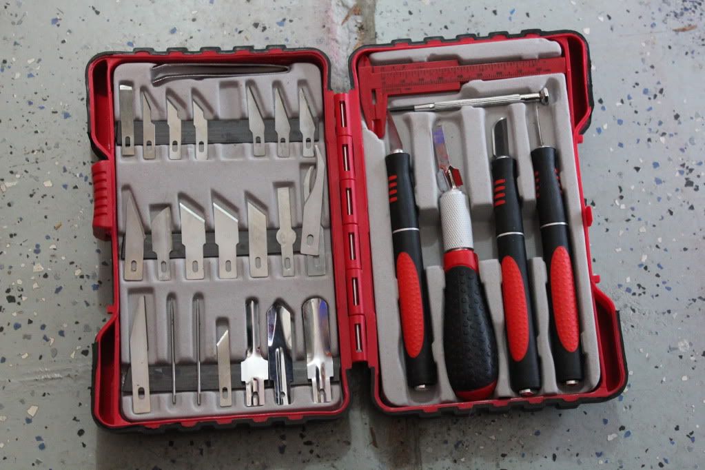

Next, I went to harbor freight and bought me a set of exacto knives, although any sharp blade will do for this job. I liked this kit because it serves me for multiple jobs.
