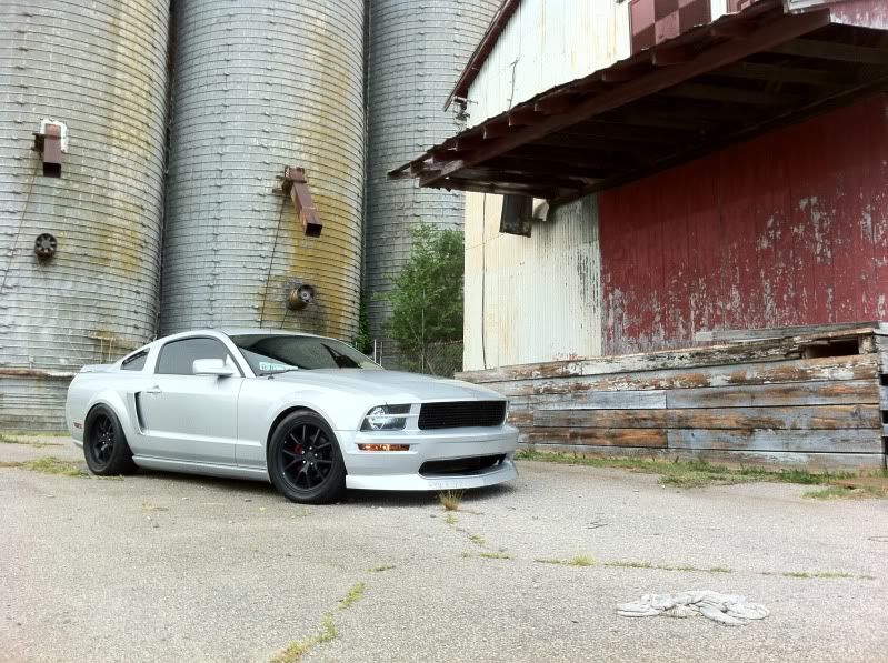

I've got the eibach pro springs with tokico HP series dampers. Maybe doesn't handle like a go-kart, but man has it increased my confidence in the corners and just feels faster because you can actually feel the road (but it's not too harsh).
Before and after pics:
