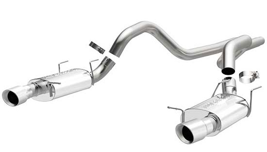

For a lesser expensive option, I'd probably go with the Mangaflow Street Series Catback System:
BBK Performance Long Tube Headers for 2011+ Mustang GT
Magnaflow Street Series Catback Exhaust System for 2011+ Mustang GT
