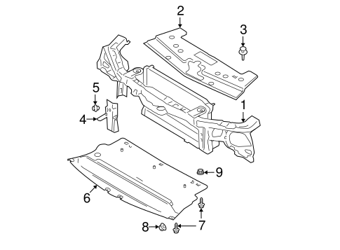

So after backing out of a couple parking spots and the front bumper / deflector catching the curb, ripping the deflector partially out, I didn't have time to repair it, so I just tucked it back in the bumper holding on by one bolt until I could find time to really deal with it. Well, Sunday as I was on the highway (I10 has a speed limit of 80 mph) heading back to Austin from a camping trip, the wind caught it and it started catching the road. I initially thought I got a flat tire, it was that bad.
Has anyone attempted to install one of those before and have any pointers? I'm thinking about trying to do it myself. I also want to either build myself a couple ramps or buy a pair to be able to do this.
The deflector is # 6 in in the image below
Thanks

I know I've done that job, but there wasn't anything any more memorable about it than the fact that I had to do it once. A few bolts, and the deflector goes above the bumper cover or whatever plastic piece is in front of it. You'll be fine.

Some of the screws that hold it in go through the bumper cover at the front. If it tore the bumper when they came out, you're gonna have to put some new holes in your bumper, but you can probably keep your deflector. If it tore out of the deflector, you're in good shape. Just make sure you get the clips the screws pass through, if you lost them when it came apart.

Thanks for the info guys. I still haven't gotten under the car to see what bolts/screws I need to replace but yeah I can definitely tell you that at least one of the holes in the deflector got ripped open on the back side of it closest to the radiator. I just found an ebay seller that is selling them for $36 new instead of the $59 Tousley and other online parts stores are selling it for.

I replaced the one my '09. It will take you about 30 minutes. Couple of bolts and some push-pins. I bought some Rhino type ramps a couple of years ago. They have rubber blocks on the bottom to keep them from sliding. They work great and are much lighter than equal size wood ramps.
Keep in mind the one you are buying on ebay is most likely not Ford OEM. Probably just fine for this application.

My brother-in-law’s GT500 has a similar problem, but the metal clips that attach the deflector are gone or broken. Like the ones on the back (motor side) of the deflector that go into the blind square holes in one of the metal support brackets. I think it’s #9 on the OP’s image. A nut & bolt won’t work because I can’t get up in the hole to hold the nut in place. Any ideas on where to cheaply pick up replacements? Thanks...
You can usually pick these up at a local auto parts store like O'Reilly...
U Nuts
...and take one with you when you go to get'em!
