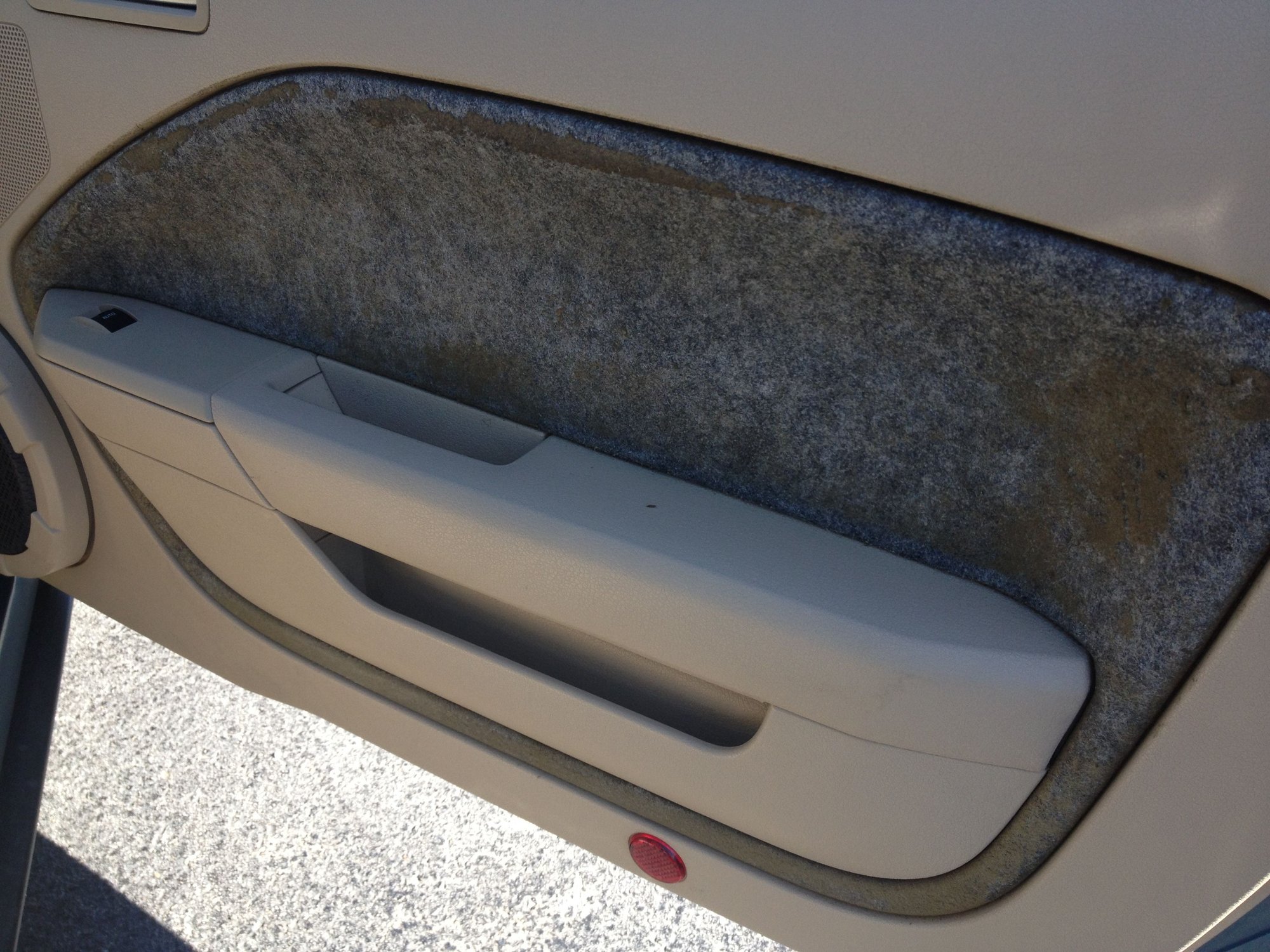

I got these:
I've seen other similar years similar prices look better. So does that mean they might have hidden/mechanical issues, or is this overpriced?
These are the cosmetic issues with the vehicle:
-Top has no tears or rips, however, the back glass is somewhat dislodged from the top allowing for some seepage
-Both door panels need lining reinstalled
-One larger ding on passenger door
-There is only one small spot on the leather upholstery on the passenger side
This car is NADA average retailed at $8425. The estimated costs to fix all of these issues, if one chose to fix them, is between $1000-$1700--$500 for top (part only) or $1200 top installed, $250 for door panels, $250 for ding in the door. This still leaves the $6500 cash price below average retail.
