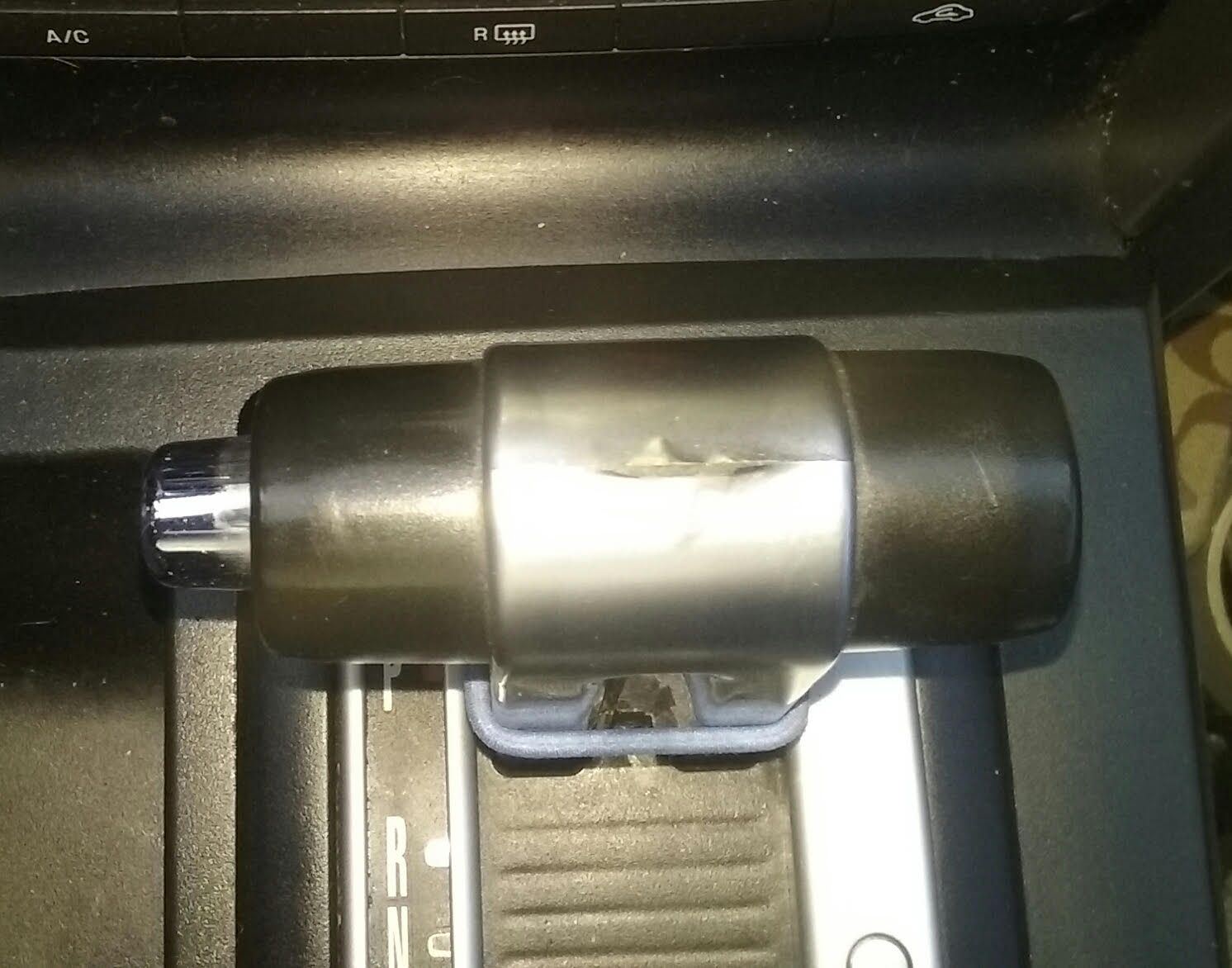

My friends 2007 V6 automatic shifter handle is cracking at the top. I haven't looked at it yet, but she said it's plastic. The only way to replace it is to replace the whole shifter and she can't justify doing that when there is nothing mechanically wrong with it. I thought maybe a heat gun could possibly melt it back together? What do you guys think?

She said so far she has had no luck finding one in a junk yard. The piece keeps cutting her hand. I wonder if the heat gun doesn't work maybe try making some kind of leather strap to go over it. She said she is tempted to just putting some duck tape on it but knows it will look ghetto.

How about filling the gap with 2 part epoxy?

How about posting a photo of it and perhaps we can offer advice on a fix!!

She sent one to my phone but for some reason I cannot send it to my email address. I've notice people with Apple phones or who have Verizon does that. I have a Samsung and I use Sprint. I did ask her to send it to my email address.

Here ya go;
See the crack on top?

File it down......fill it with epoxy if necessary.....smooth it and paint it......VOILA....FIXED!!
