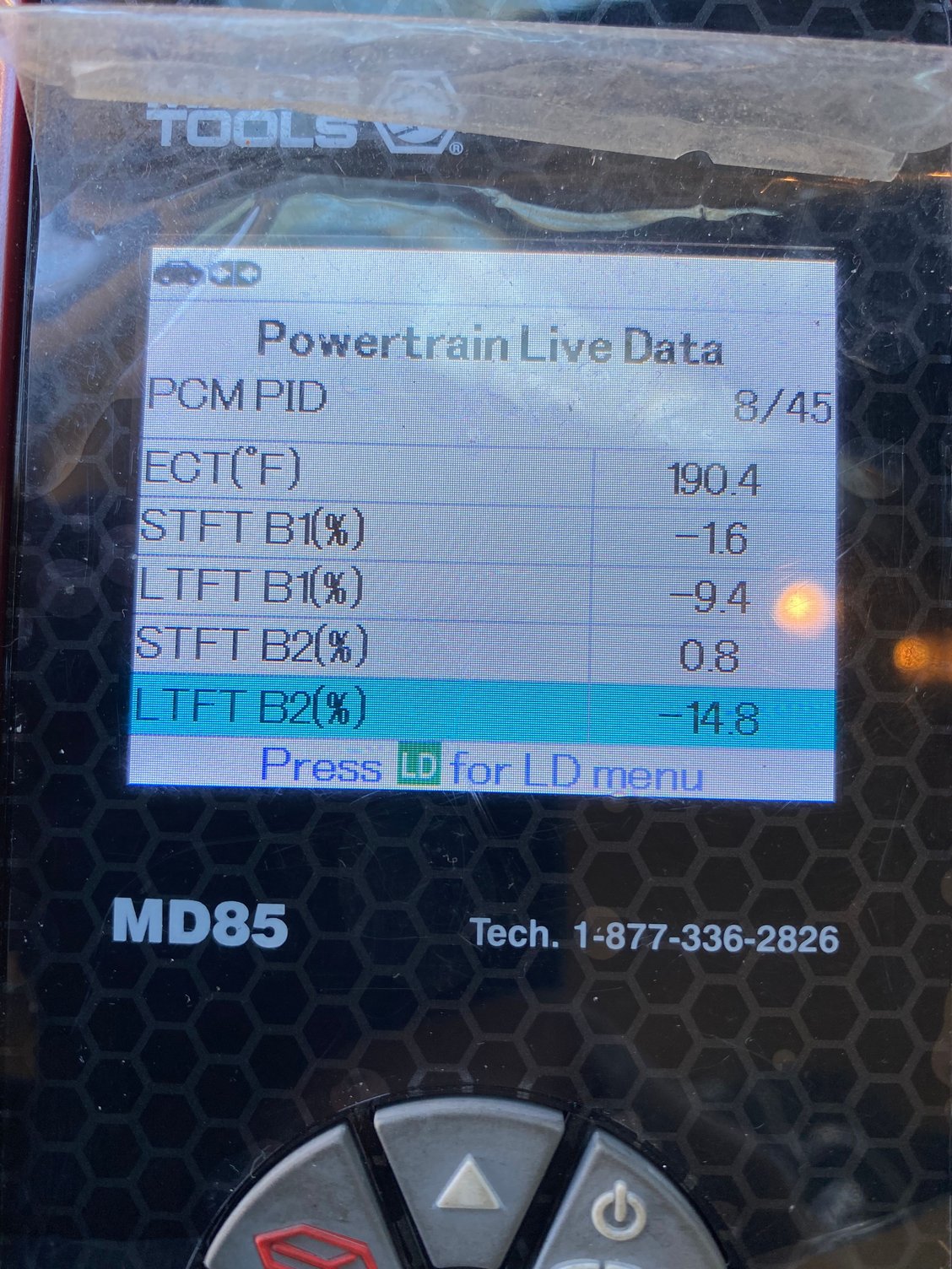

Well I forgot to mention I’m running an off-road xpipe, but I checked the fuel trims and LTFT bank 1 comes in at about negative 9-10 and bank 2 about negative 15.. the STFT both range around 0 (which I believe is alright lol) the fuel pressure is also at about 39psi. All of this is at warm idle. When driving both fuel trims go up around positive 1.10-1.15 and very rarely but does happen, drops down into the slight negatives when I give it gas and it bogs... I just cleaned the MAF today and I also forgot to mention that very recently before all these problems started to happen I changed the fuel filter (the correct way haha) the car still hasn’t thrown any codes at all either

Also here is a pic of the live data at warm idle, just Incase I’m getting something confused

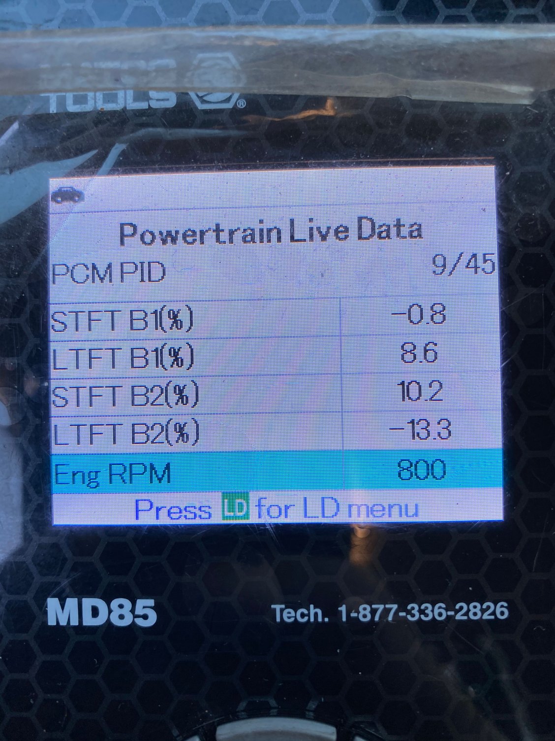

So this was after about a 10 mile trip on the highway, it ran about the same way the whole trip with the HTFT going up into the high 20s at times... i obviously have no knowledge about this stuff, but is one bank running rich, and one lean?? What would cause that??
