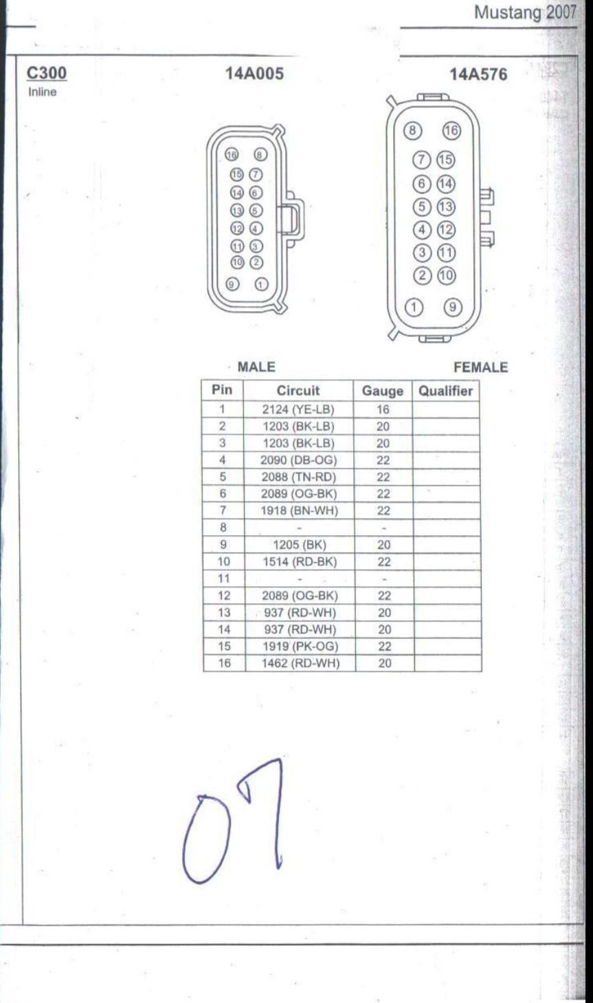

So recently I came into possession of some powered seats out of a 2010, and I’m trying to install them in my 2007 (came with powered seats
the problem I am having is that even though the plugs are the same, the connectors are pinned differently between model years
does anyone have the proper diagrams for these, or at least a guide on which wires would need to be changed?

Basically I need something like this, but for both driver and passenger sides for 2007 and 2010

Ford Workshop Service & Repair Manuals - fordrepair.info - 2011 Mustang 2011 Mustang 120 - power seats (iihs.net)
doesnt show the actual "pin" location but maybe you can check wire colors year to year and get it to work. good luck

Thanks, but that has one diagram that covers 2005 to 2010
i know the connectors changed in 07, and the wire colors are apparently different every year
maybe I can just swap the harnesses

So for anyone wondering, swapping the old harnesses into the new seats was definitely the way to go
