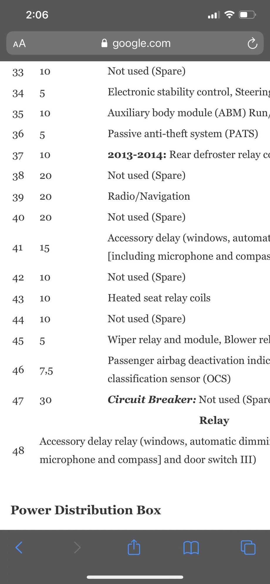

2012 Mustang V6
My heat and air keep going out along with the wipers so I checked fuse #45 and it was blown so I replaced it but it’s blown again. What should I check? Thank you so much in advance.

Check for frayed wiring in the circuits to both. There's obviously a short somewhere that's blowing the fuse.
