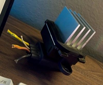

So long story longer, it was the blower motor resistor/the wiring harness. The water dripping in thru the blower must have shorted the blower motor resistor and/or corroded the harness (green buildup..). I replaced both components with a kit from Amazon and everything works like new again. Some help diagnosing this with an OBD2 Scanner and ForScan aided me in solodifying the fact that the issue was in fact with no electrical current reaching this component. Thanks for all the help and support!!!

Thanks for posting back with the fix and mystery sound resolved.. Sounds like the sizzle was the water hitting the heat synch?

I'm not sure if it was hitting the heat sink or the blower itself. When I noticed which driving actions caused the sizzling (quick accel/deceleration & full 90-degree turns during heavy rain with the climate system on; pre-drain clog fix), I messed around with some climate settings to see if the sizzling reacted positively or negatively if not at all. What I found was when the blower was in a high setting it got worse, and when I shut the climate system off completely, the sound would fade out. This lead me to believe that water was being introduced directly to the blower fan (especially after finding that clogged drain right next to the firewall AND cabin air filter), but what a strange sound...It really would not surprise me if it was the heat sink.
