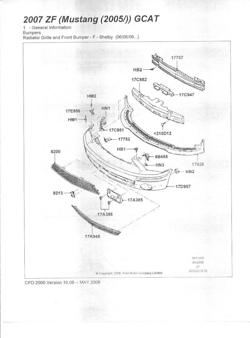

You need to use the front wheel liners from the GT500 ( only the front half) and the foam piece behind the front bumper as they are different. Also you'll have to use the wires from the GT500 to the fog lights as the GT's won't reach - cut and splice. Other than that everything else bolts right up.
I used this parts list to order from Ford dealer back in 2007.

Here's a list of parts I acquired and used for this conversion:
