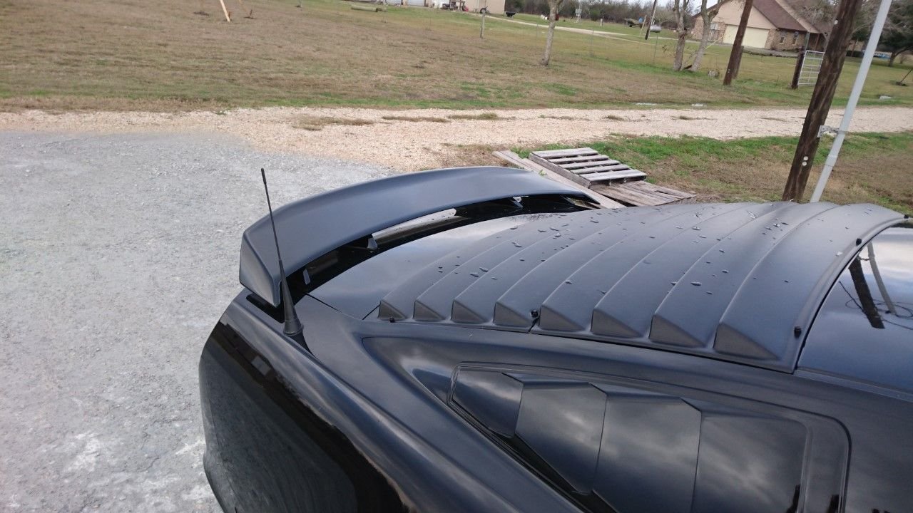

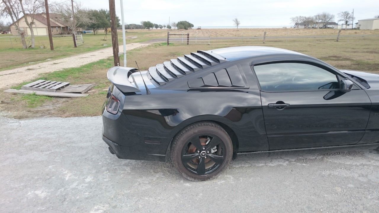

I've been working just about every day lately, but I finally got around to installing it and taking a couple of pics. I think I've done about all I want to on it cosmetically. It's time to look into suspension and wheel upgrades. Maybe brakes after that. I want this car to handle a lot better before I add any power.
