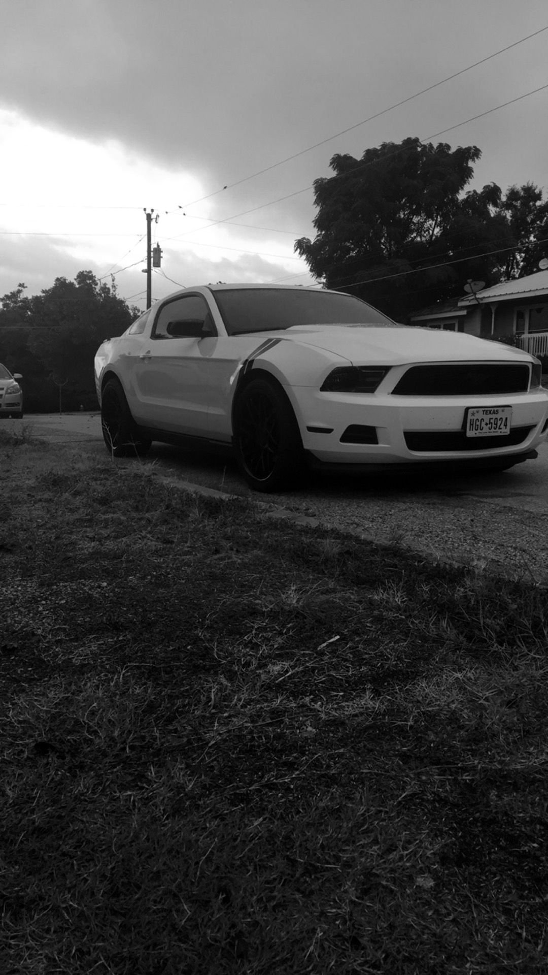

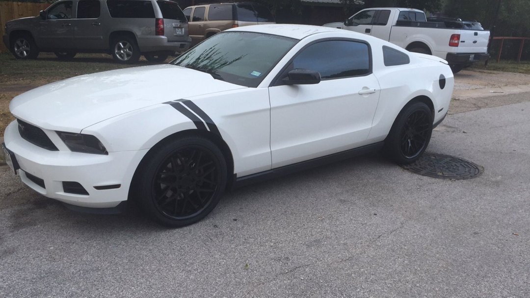

Mods so far:
Airaid intake
Borla Atak axleback
20" ZR downforce concave staggered
275 rear 255 front
BBK LT headers
Smoked lense kit and fender hash marks from American Muscle.
Here in a few weeks I'm picking up a tune from MPT and plan on getting the ghost cam tune as well.
Also plan on lowering it a bit. Maybe an 1"-1.5"
Here's some pictures.

3.31's are fine, that's what i had but changed to 3.73. If your doing away with your catts, it would be easier to buy a 'off road' matching x pipe. Long tubes are very easy to put on yourself and your going to feel a lot of extra power on your first drive. I ran my long tubes for around a month before i had my tune changed, with no problems. When i got my new tune i couldn't feel any difference between the two. Nice looking Mustang
