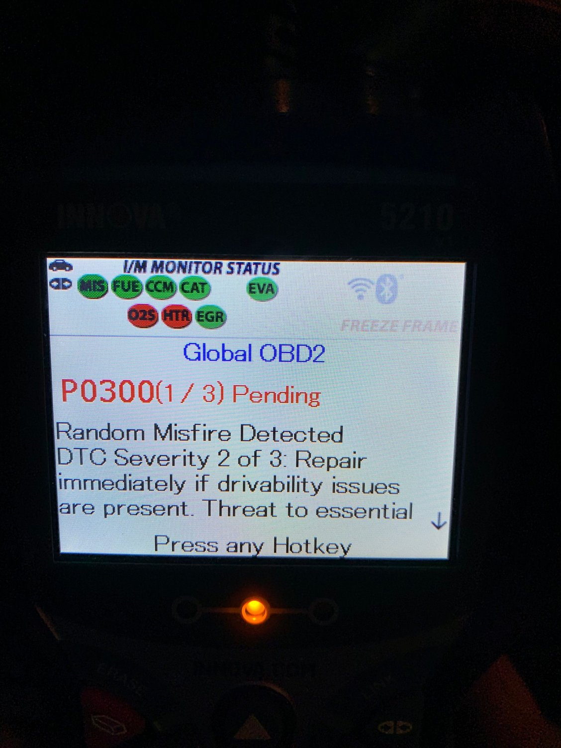

Can anyone help me understand why the O2S and HTR flash read while I’m having a misfire?

Have you recently cleared the cars codes on your car to see if they come back? If so, those two monitors haven't completed their readyness cycle and are probably flashing when the cycle to "make them ready (green)" is interrupted. Several different pending codes (like a misifre code) will impede their ability to turn green and be "ready".
What's been done to the car? When did the problem start?

I have chased this misfire for a month now. It was after I took it to the dealership to get its first clutch change (at 123,000 miles). They replaced the clutch and flywheel, and after I got it back it started having misfires. It was only on #3, now it’s moved to both 3 & 4. I’ve replaced coil packs, spark plugs twice, injectors and MAFS. When I changed the canister purge valve, the misfires stopped happening frequently. I used to get at least two misfires a day driving, now it’s only when I run it hard. But I got tired of having to call people and take my car places because they could never find anything, so I bought a scanner to see what’s happening when the car has a misfire. The gas mileage still seems a little bad than before, and there’s excessive heat under the hood. The electric fan is always cycling on and off. I’m thinking it’s either plugged cats or the O2s. It never throws a code for malfunctioning O2s or for the cat. So I’m not sure about this. I’ve been throwing parts at it and the issue is still there.

So you had the clutch and flywheel replaced, important piece of information. The fact that it started happening right after the clutch replacement tells me that something was missed in the installation.
Whenever you separate the engine and transmission you have to do the crank relearn process. If that isn't done you will get random misfires just as you are experiencing. And it will damage the engine eventually if not repaired.
The crank relearn teaches the computer where everything is so that proper timing is set; without doing that you could have the computer calling for 20 degrees of timing but the engine may actually be getting 30 or 40 degrees because the computer and engine haven't been together.

So how do I perform this crank relearn? Is this something I can do without taking it back?

If you have a SCT X4 type tuner you can do the crank relearn. If you don't have that capability with your stuff, then the dealer can do it.
Had to have it done to my 2013. The guy who replaced engine #3 didn't do it and I almost lost engine #4 as a result; didn't figure out that he hadn't done it to #3 until #4 acted up.
