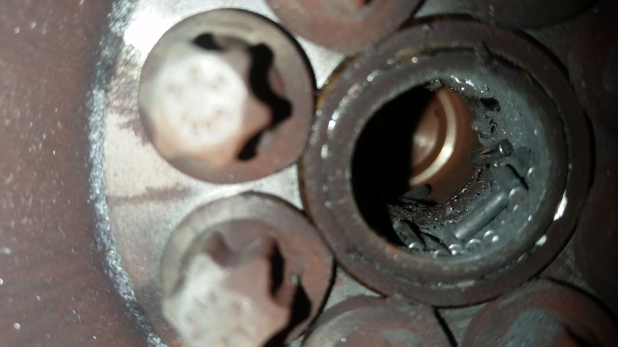

I just recently went through this. Mine ended up being a disintegrated pilot bearing. I though mine was the slave as well and ended up having to pull the transmission twice when that didn't fix the problem.(fun times)
It would have to either be a mechanical or hydraulic issue. The mechanical issues that would cause this would be, Pilot bearing seized and not letting go of the input shaft, or a bad clutch pressure plate that won't disengage from the flywheel. Also toasted bearing's on the slave.
The hydraulic issues would be, leaking slave, leaking clutch master cylinder, or air in the system.
The hydraulics would be easy enough to check. Just get the car in gear, disengage the clutch and hold it to the floor. If one of your components is leaking the system will eventually lose pressure the clutch will start to engage on it's own.
