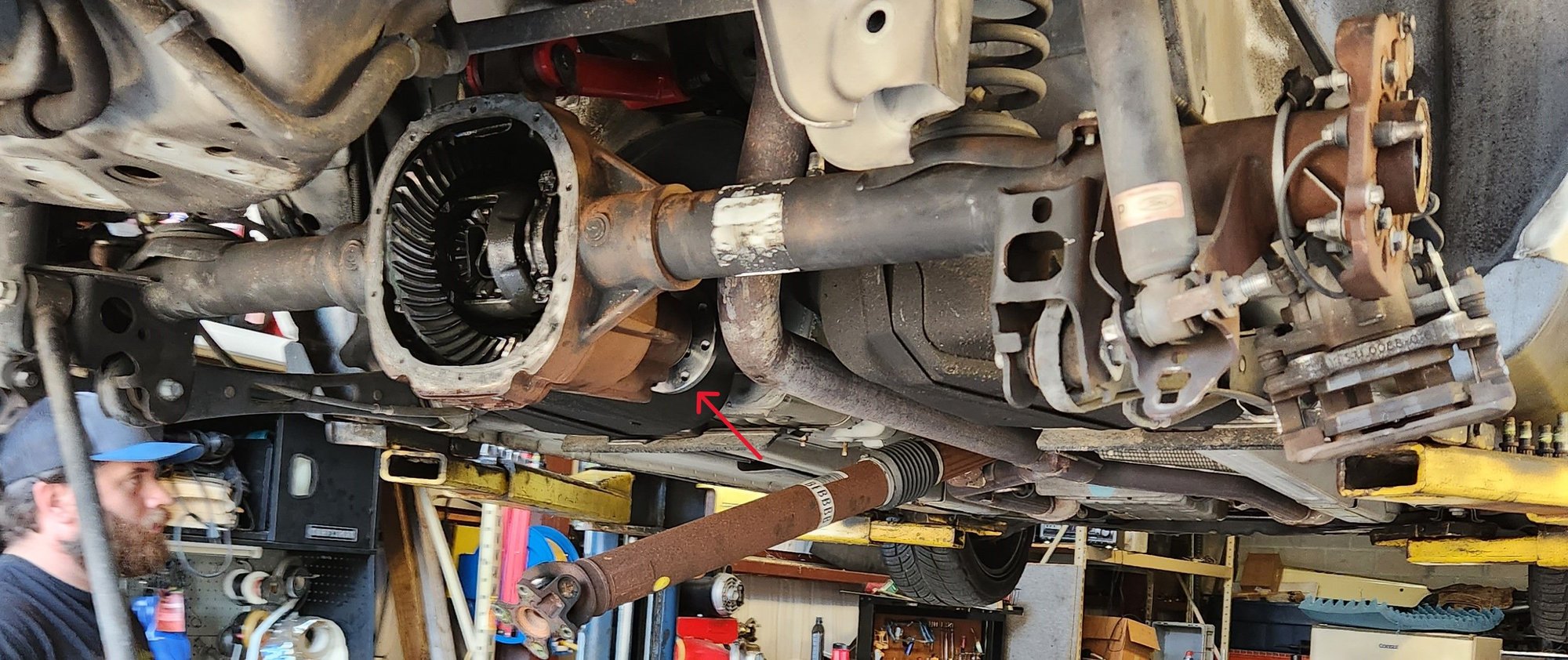

Yes, at the junkyard I stumbled upon an '09 GT with 3.73 gears and swapped it into my '07 V6, no issues at all.
The arrow points to the Cobra flange that was installed to connect it to the V6 driveshaft.
The lower gears really woke up the V6 and now I don't have that annoying right rear spin every time I make a turn from a stop sign.
