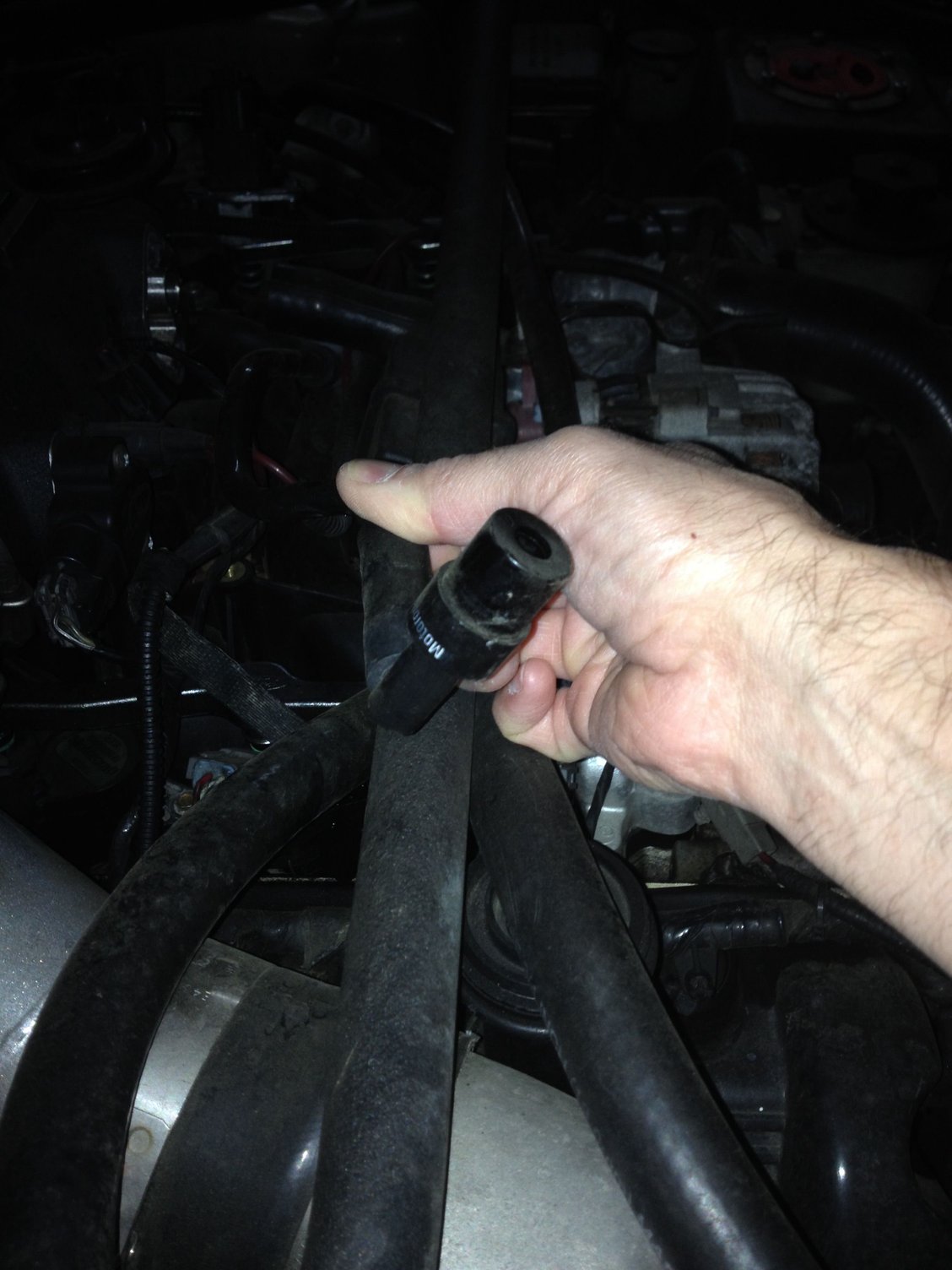

Right next to where the IAC mounts on the throttle body housing is a tube that doesn't connect to anything, but has something stuck one e other end of it. Is that normal? The tube and the thing stuck on the end is pictured below. The "thing" is in my hand.

thats your pcv valve, thats supposed to be in a grommet in the valve cover, you have a large vacuum leak with that sucking non metered air from outside the crankcase. fint the grommet on the valve cover and reinstal, should fix u up

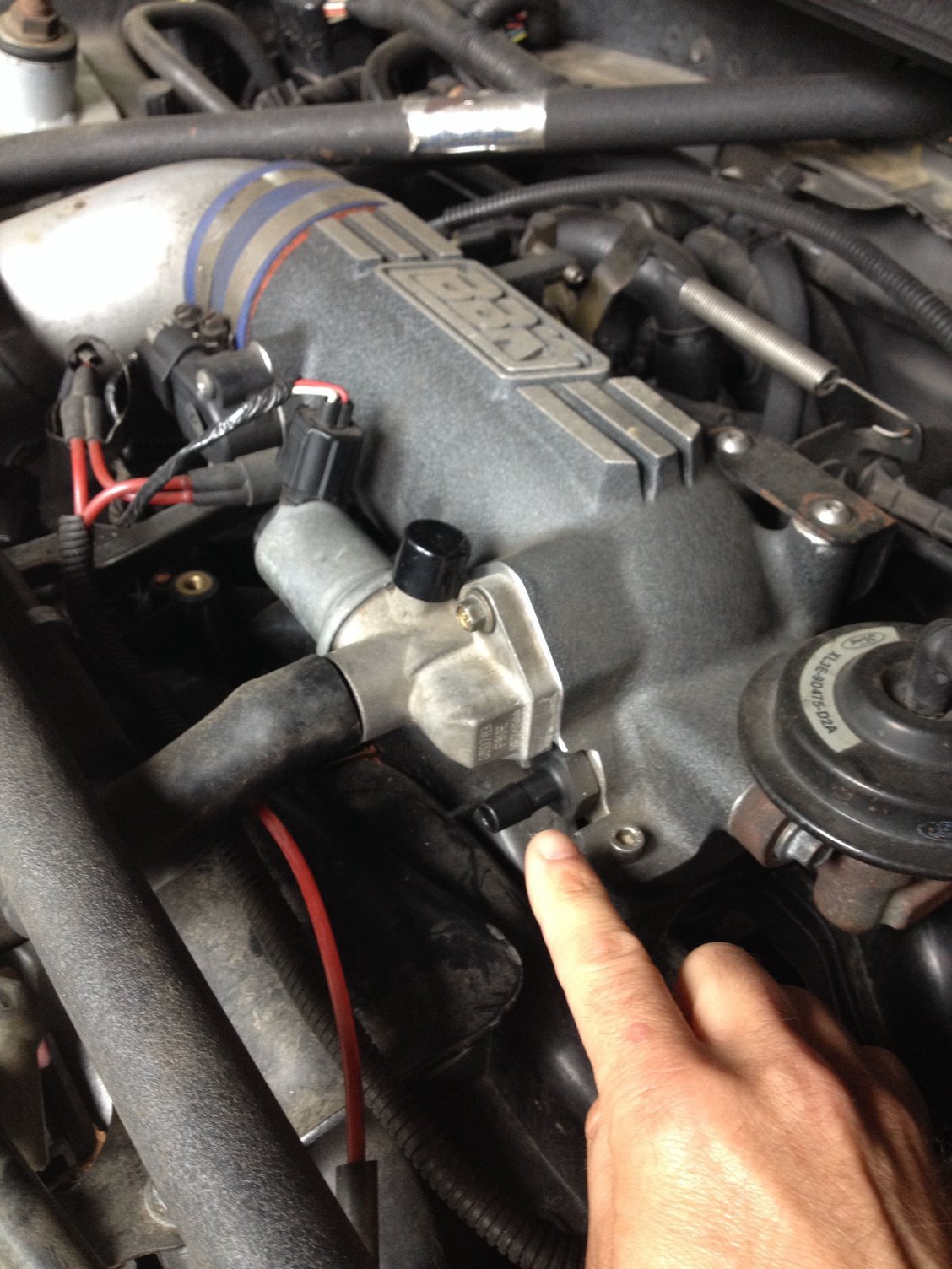

I don't think I'm explaining this well.
Im not talk about the fresh air hose that attaches to the IAC. I know where that's supposed to go. I'm talking about the fitting on the throttle body housing right next to where the IAC bolts up. On mine there was a PCV valve attached to it (see pic a couple posts back) which I understand makes no sense. So I'm wondering if that should then just be capped off or if there is something supposed to be attached there. See the pic below. I'm pointing to the fitting.
And I don't know if the IAC is bad. That's what I'm trying to determine. When the car is started, 12V is applied to the IAC. When that occurs, the IAC does nothing on mine. I tested it connected to the harness on the car, and also to my bench power supply. Nothing happens when 12V is applied to the IAC. I can feel the slightest little something, like the motor is trying to do something, but nothing actually moves. Does this mean it's bad? What is it supposed to do when power is applied to it? Because mine does nothing.

ok, thanks for the pic, first ? is there a pcv that is properly installed? mine doesnt have that extra port, if there are no other disconnected vacuum lines, and there is a properly installed pcv valve, then cap that port, and clear codes, then see how it runs. next, im not sure if jumping power to the iac will result in much of anything that is usefull as a test. when in doubt, replace it, especaally when its as affordable as that
