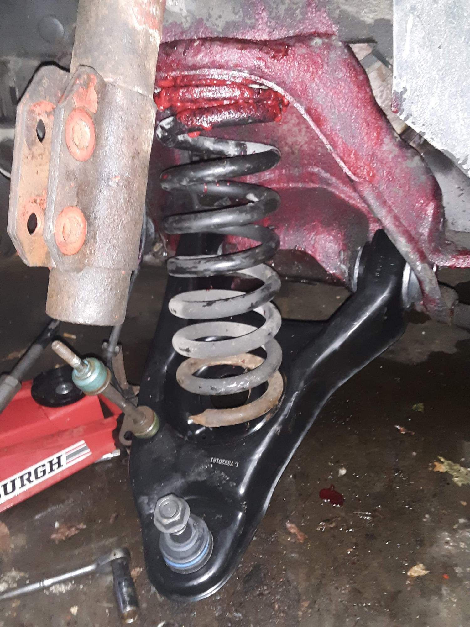

I appreciate it. Brake pads seem to be worn evenly on both sides, and the wheels seems to turn freely about the same. However I did find something I noticed the driver side balljoint wasn't fully seated.. maybe about 1/8 of inch gap between the a-arm and bottom of the joint. So I decided to undo the spindle and strut and once I took tension of the joint the balljoint just fell straight out. I can literally press a new one in by hand. So that hole stretched out pretty bad. I ordered a new control arm and I'll be putting that in sometime in the next couple days and re-evaluate if the problem is still there or not

Update: new control arm is in, once the spindle and everything was off the old arm I just tapped the top of the balljoint with my palm and it fell right out.

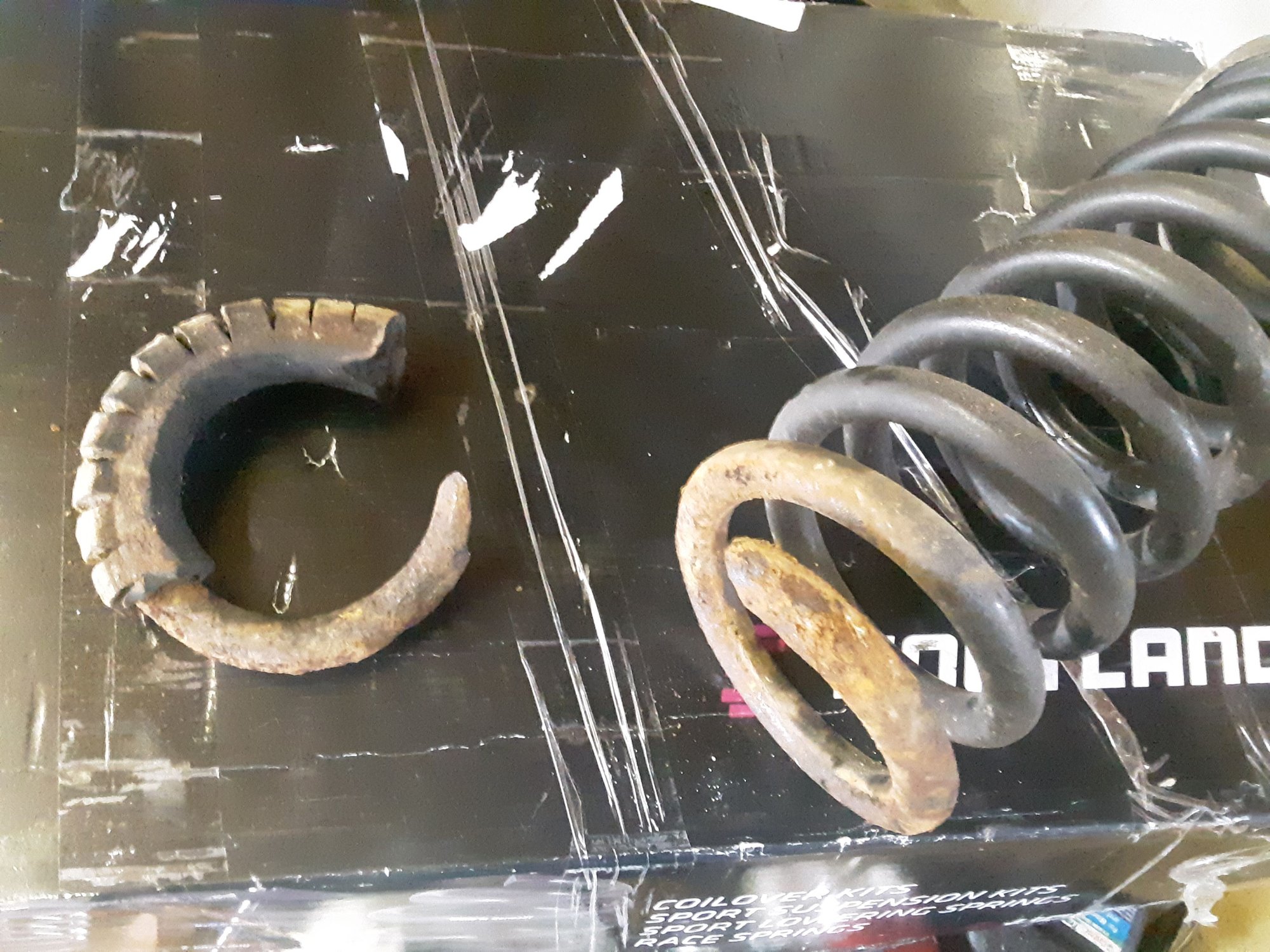

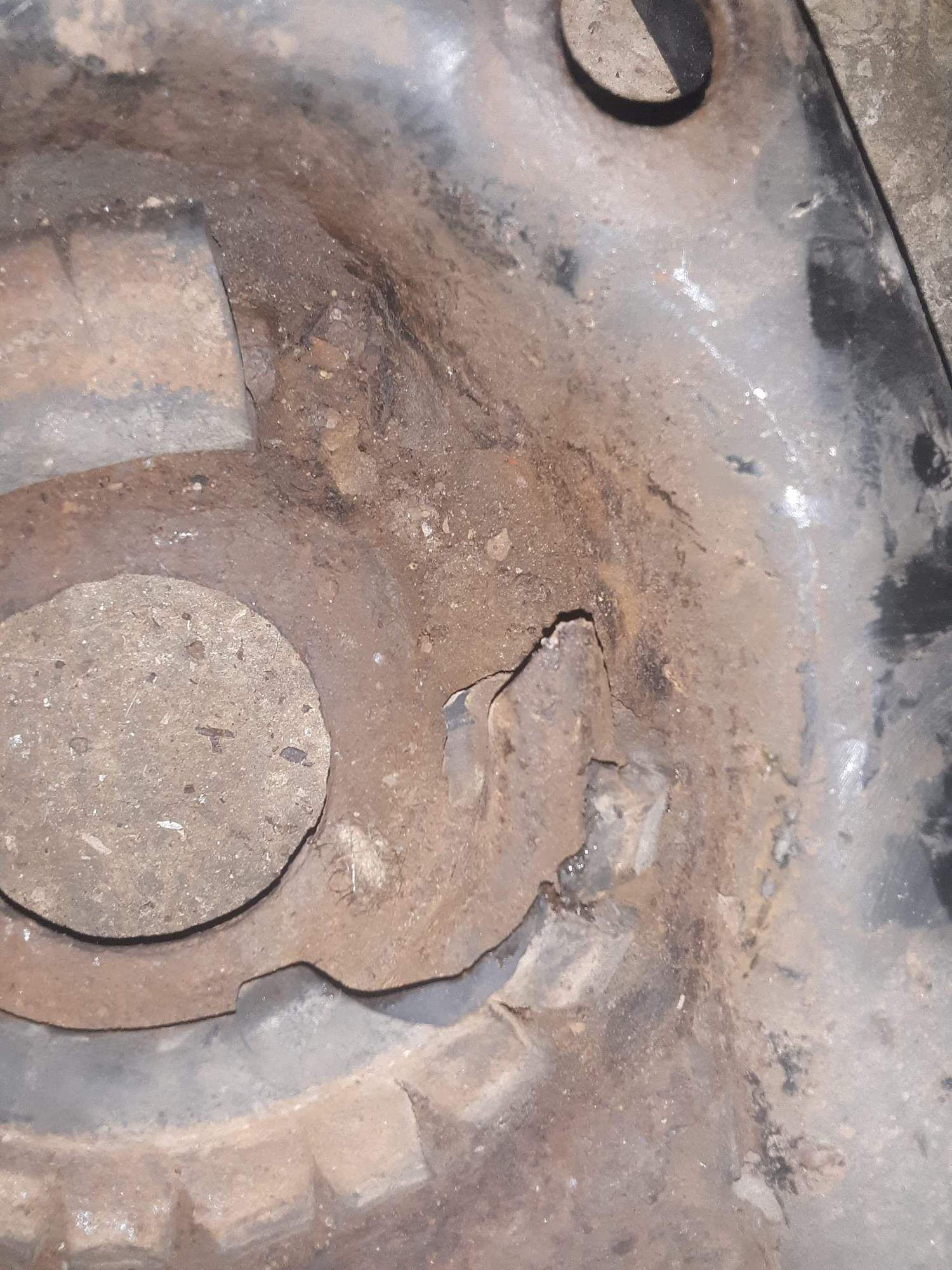

I noticed coil spring was broken about half inch off where it starts into the bottom isolator.

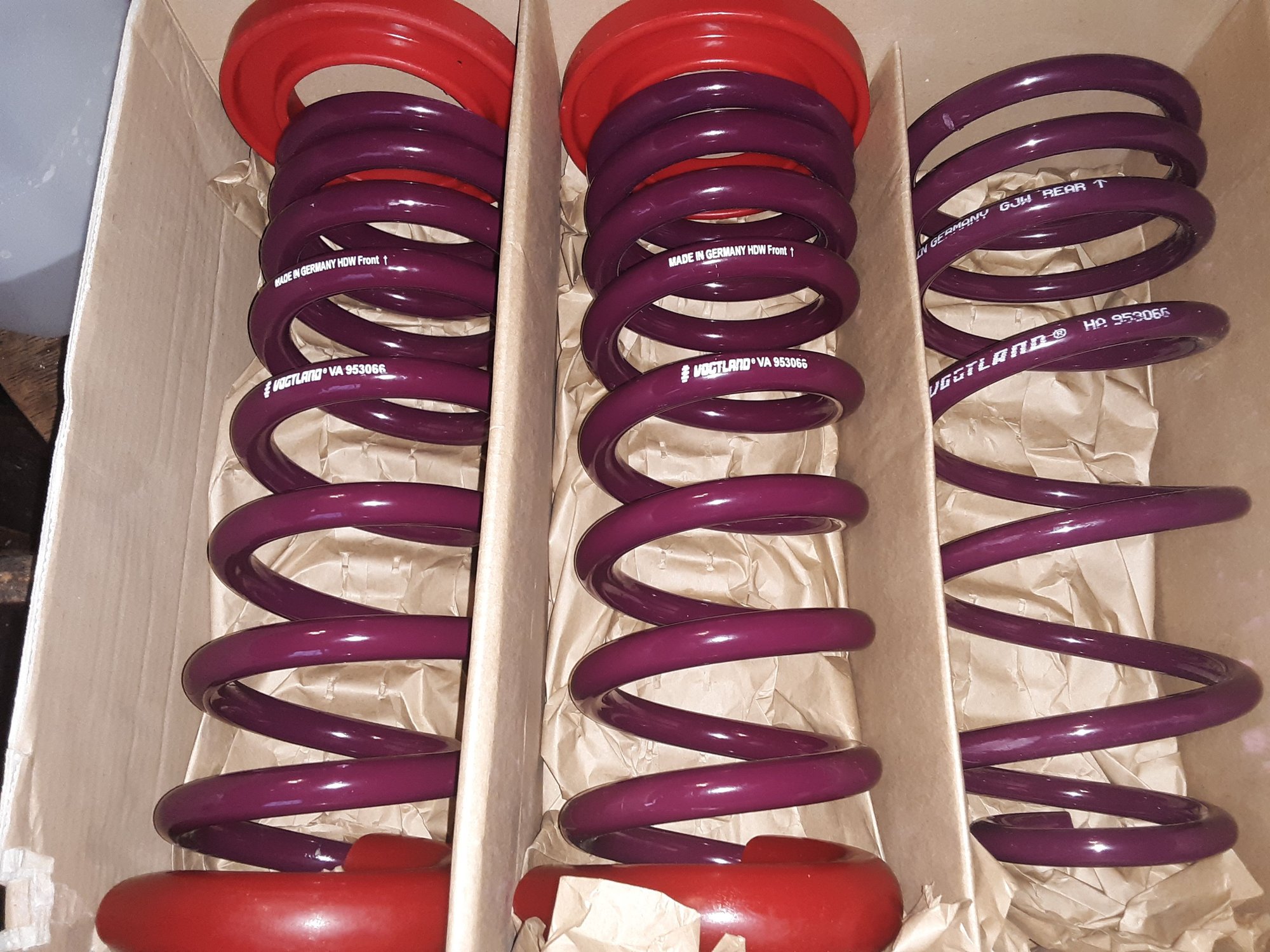

I ordered new lowering springs and isolators. Right off the bat that clunking is gone, alignment is way off now for not even touching the tie rod ends.

The spring itself was broken? Definitely get an alignment after you replace them and let us know how it goes.

Update again. Front coil springs are in, everything is pretty much back to normal. The alignment is off of course that was to be expected, but the difference is night and day. The steering wheel actually returns itself and the pulling to the left side is gone when braking. The passenger side spring was actually the worse. It was broke off a full coil and the driver side spring was broken off about a half coil. It was so bad the the 1 1/2 lowering springs I put in barely lowered the car anymore than what it was. I hope this helps anyone who ever comes across this sort of issue.
